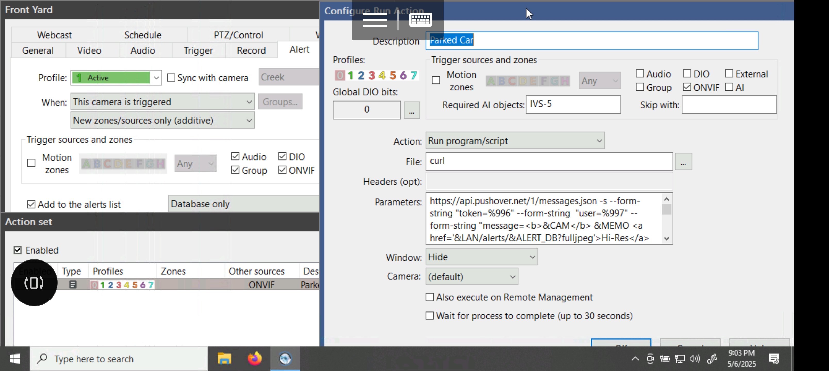

Now, I am looking at using Empiretech/Dahua cameras IVS as a better AI confirmation service, and specifically, for a parked car. The same camera is also watching for people and cars.
What I would like, is to have IVS-5 become an alert, but ONLY IVS-5 sends a pushover notification via the "On Alert" button
Is this possible? or do I have to have a duplicate Blue Iris camera set up for just this alert?
It is possible.
Simply go to the alert and create an alert where the Required AI objects is either "IVS-5" or "Car Parking"
Thanks. That seems to make sense, but it isn't firing. Is it a problem to have multiple Ivs rules in one camera? For example, when I test parking detection, I just get the Car Slow IVS, and never the Car Parked IVS
Use the "New zones/sources only (additive)" option if you are going to have several rules being used in one camera and want to be able to do something with each rule separately. This will generate multiple triggers.
OK that worked, problem mostly solved, I get an alert in the alerts panel now. Pushover alerts aren't working though. I wonder if there is a problem with the image path now that it is onvif not BI motion
Hmm. My Pushover alerts work and I am only using ONVIF for them.
For kicks check the External and AI box as well and try again.
I think I have this solved... "IVS-1" etc doesn't work, but the memo does- IF you don't have a space in the memo name. That kills it. "Parked_Car" works "Parked Car" doesn't.
