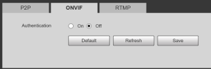

Hi everyone. I am having a hard time getting the ONVIF working on my cameras. when I try adding "&unicast=true&proto=Onvif" to the end of my stream profiles, I get a port error.
You need to check the get onvif triggers and make sure onvif is enabled on the camera.
Hit the find/inspect and post a screenshot of the pop up window as that will give us a clue.
sorry the get onvif triggers is checked, i was going back and forth so many times i posted the screen shot with it unchecked, but it is checked.
Instead of typing it in - select the pulldown next to default and see if it shows mainstream and substream - if so use those

I tried deleting the camera and adding it back using your method of putting in the IP address. Same deal - just (default). The camera works, but as soon as I add "&unicast=true&proto=Onvif" to the stream profile I get the port error.
Ok try the method I suggested. It can make a difference.
