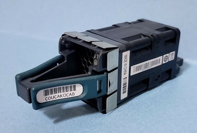

I don't where you are gonna find a different fan. Those are pretty proprietary i think. but I'm sure somebody has done something to try and control Db ....at some point...somewhere....

Appreciate the links for the power supply and fan. Having a source for replacements parts is a plus.

Now that NVR-5216 is a fan noise you can modulate with a Noctua fan. I have nvr 4108 and thats tolerable and it might use a similar fan part# as the 5216.
The nightowl/Hik fans were annoying. I bought the noctua fans for them and they are quiet. SO much so that I could finally hear the Cisco LOL.
