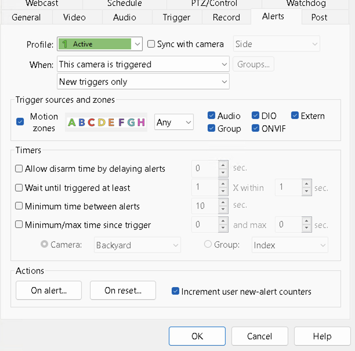

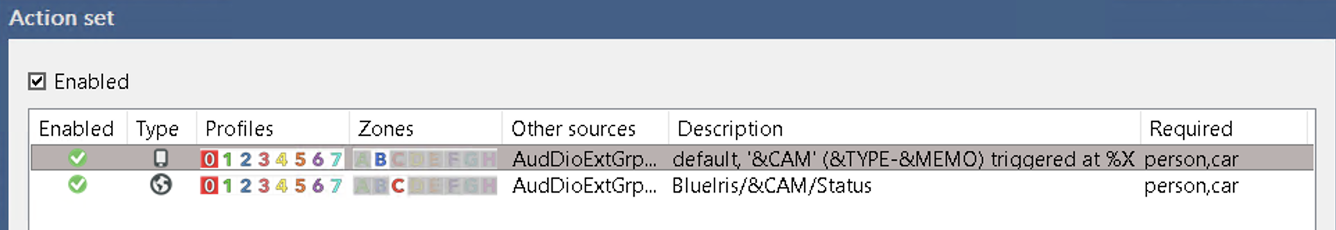

I am trying to configure multiple Zone in BI to trigger different alerts.
For example:
Zone A: Trigger Recording
Zone B: Trigger Phone Alert
Zone C: Trigger MQTT
It seems as though I am getting phone alerts every time Zone A is triggered even though I've configured it the On Alert for Zone B only. I also had an issue where MQTT Triggers in Zone C were only triggering with People and Cars weren't (Although this did work previously and an upgrade may have broken it).
Is what I am trying to do possible?
