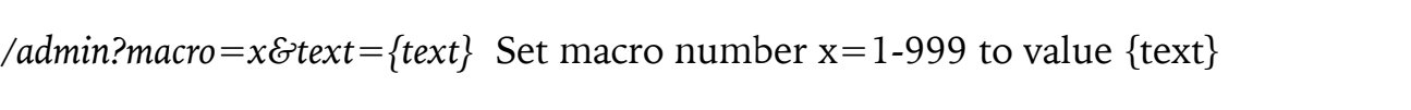

I would probably play around with setting a different macro for each gate using the Blue Iris HTTP interface command
Then use logic to determine whether to arm/disarm the other gates.
