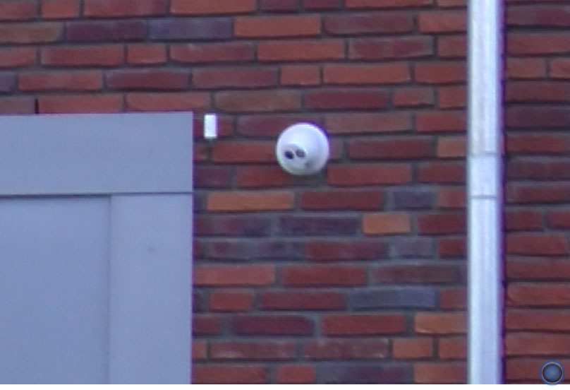

Funny it seems this camera is super popular but I cant find one picture of this specific camera with the inside ball(the actual camera part) rotated. Or a video showing mounting range of angle. In all pictures that rectangle part of the camera (that you see in the lens) is always the same orientation within the turret housing.
Or maybe I'm misunderstanding how you setup this camera. Is the picture orientation adjusted via the software?
Could this camera in the picture attached here, using the special mount, gotten the same angle of view without the special mount?
Okay not sure exactly how to read the specs. But in the specs it shows it only looking sideway, when mounted on a vertical surface, if using a special mount:
I see this: "Pan/Tilt/Rotation Range Pan:0˚~360˚; Tilt:0˚~78˚; Rotation:0˚~360˚" So from this can I assume the ball part of the camera can be rotated? I've just not seen any pictures showing this. Not that I need to see a picture but it would give confirmation.
If it needs a special mount then I maybe should be looking for a bullet.
All the videos I've watched including yours only show the picture quality, Not in what ways it can be mounted.
I'll take some pictures when I get home. I have a 5231 on a temp rig.
@nary's picture in the first post here should give you an intellectual idea of what it's capable of (scroll to bottom of first post):
Okay missed looking at this picture closely. Here it appears the ball part of the camera is rotated within the turret housing. As you can see the rectangle within the lens at a different orientation to that cutout in the housing.
I am assuming that the "rectangle" that I see within the lens needs to be oriented for the most part horizontally.

Okay thank you aristobrat, so you do have to physically adjust(rotate) the camera "ball" within the turret housing to make the scene level, and keep that rectangle you can see within the lens mostly horizontal. That was what I was wondering. And from that picture I posted above of the camera in the box it shows the ball rotated in relation to the cutout.
So I am to assume that a special mount like it shows in the manual is not necessarily needed.

IMO, I can't think of any reason why you couldn't mount a 5231 to the wall directly and aim it like this 5231.
