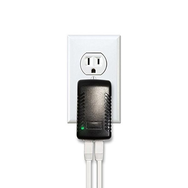

If more POE power is needed for the camera plus IR lamp give one of these units a try. It is 30 watt wall wart for an IP cam. Use it as a substitute for your present 48 VDC POE supply.
They are half price if purchased in a box of 4 units. Use these here for setting up Dahua cameras and to run one remote camera via a RF link.

If more POE power is needed for the camera plus IR lamp give one of these units a try. It is 30 watt wall wart for an IP cam. Use it as a substitute for your present 48 VDC POE supply. . . .
Thanks for the link. The Linovision splitter should work well, as one port allows for 8W and the other for 16W. The IR emitter is rated at 11W.
I do have a 120V AC outlet not too far from where the camera and old emitter are under the eaves, so your PoE injector would work okay if it were rated for outdoors.
