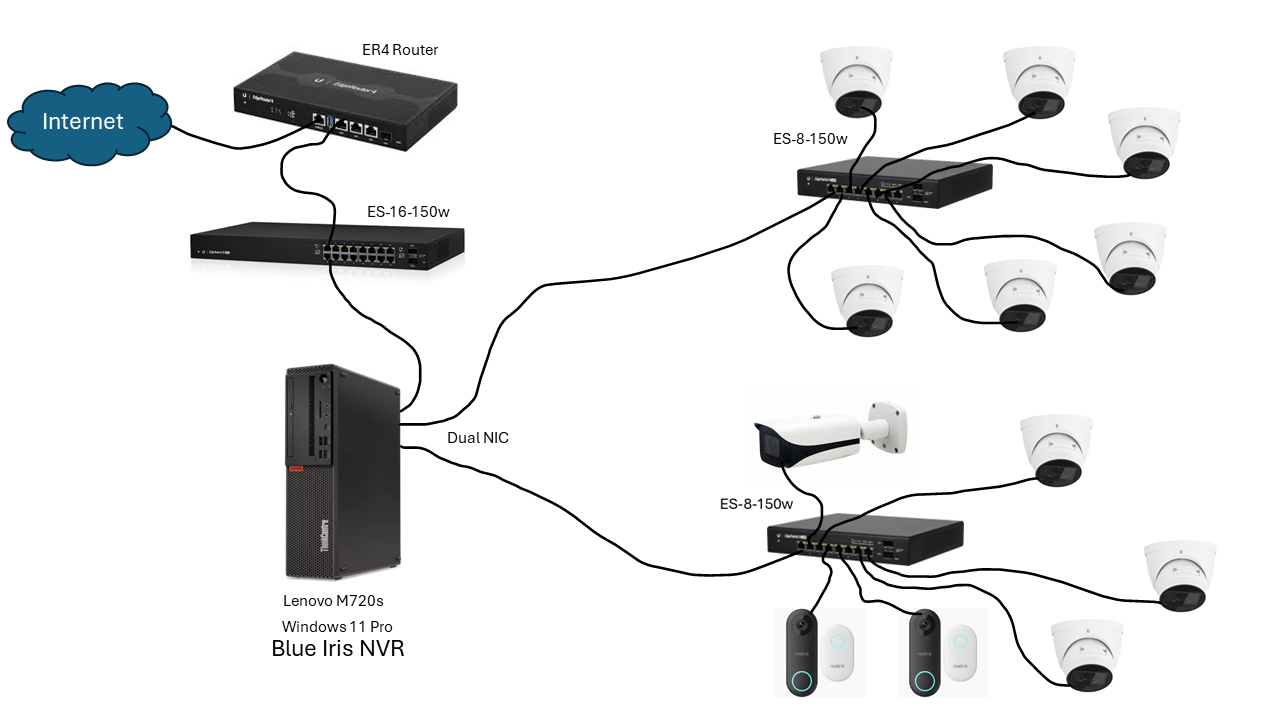

I’m in the process of wiring everything up and I should have my granny suite all finished today as well. Mike is going to help me with the setup on BI and all the cameras but he wants me to have the networking done on the Edgeswitches and the Lenovo (BI server). I know there is a wiki on this and I read it but it’s not totally clear to me how to set up the IPs for it. I assume since it’s limiting access via IP range that you don’t need any VLANs on them at all. So my question is do you set a static IP on the switches (ex 10.10.10.1 and 10.10.10.2) then allow the BI server to use DHCP on the dual NIC to set the rest of the cameras or do I set all the cameras on a static IP in that range (10.10.10.xx) also?

IMHO, if you depend on a device to always being at the same IP address you originally set it up as, always set the IP addresses up as static. Otherwise, in the event of a power failure, adding another device later on and then rebooting, you may find one or more of your devices has had it's IP changed when managed by DHCP.

Ok perfect, so static switch IPs and static camera IPs as well. Just finished running the wiring for the granny suite and need to finish mounting all the cameras on that side of the house.

That’s hilarious, been there for sure. On a bright note I got my dual NIC card today and it worked great. Looks like I have room for a second one too if I ever need it. The low profile bracket was a lifesaver, wouldn’t have worked without it. New hard drive delivery date for this Thursday. Can’t wait to finally get it online for the first time so I can start seeing some camera feeds.

I got past the camera setup first and was able to initialize all the cameras. Then after that I used the Dahua camera config tool (thanks Andy for demoing that on youtube) to set all IPs to the range I wanted to use for my network. Now I’m stuck on setting up the Reolink doorbells. I didn’t see anywhere showing how to initialize and configure them for BI but if anyone has a link that would be great.
I also started to pull some of the cameras into BI5 and I’m super impressed. It takes a little while to find your way around in the software but it’s amazing how much you can do with it. I’m definitely amazed by that Z12E license plate camera, the zoom is so good I can see bugs on blades of grass in my ditch!!! I definitely need a second one of these mounted up high on the house so I can target the road right in front of the redneck neighbors house.

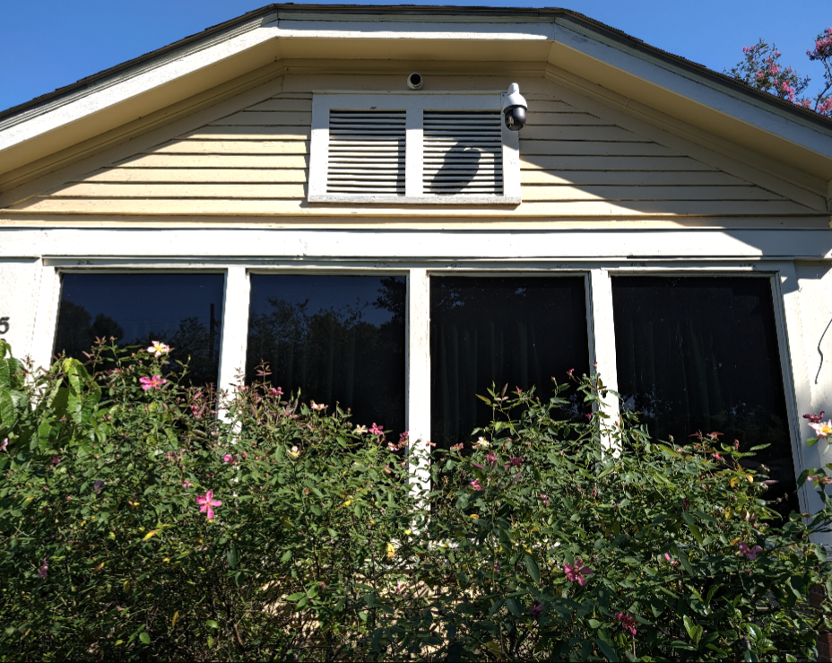

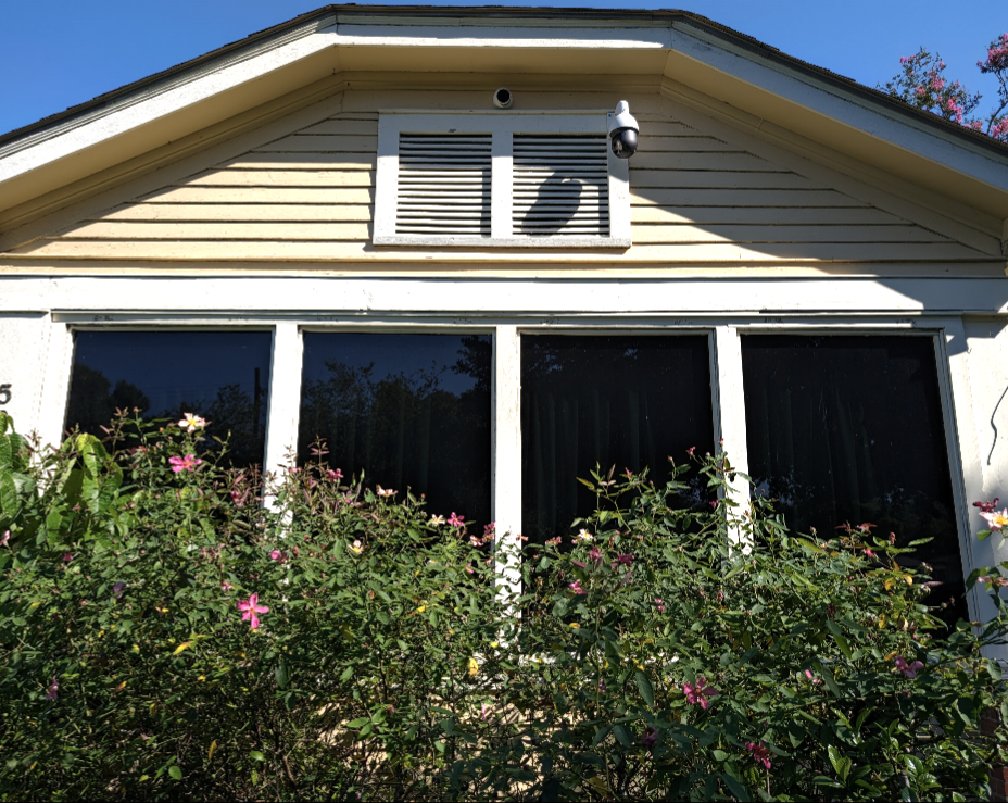

Just to let you know, that ptz round part is the size of a softball.
I was very surprised at how big it was. Luckily I placed it high enough that my wife wasn't bothered by it.
Do you happen to have a pic of that PTZ on a house just so I can get an idea of what it might look like? I’d definitely be putting it on a second story soffit for best view.

Mounted that high it shouldn't be a problem. Just remember that the closer they get to the house the harder it is to get a good shot of a person's face because the camera is looking down. That isn't a problem with the ptz @wittaj suggested if you set it to start tracking from a distance. Someone's posted how to calculate it. And if I get a chance I may dig it up.

On the other hand, if you get that ptz, I doubt they'd be stupid enough to come on your property. When I first got it, it was fun to watch as people walked by on the sidewalk and watched it track them.
