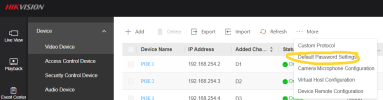

I'm pretty sure with that version, there is a setting on the devices page under "More..." called "Default password settings"... there you set the password the system will use when it adds a camera using plug and play... similar to this V5 GUI:
Most people would set "Default password settings" to the same password as the NVR password so the NVR and camera passwords would be the same as @looney2ns said...
Since I don't remember the V4 GUI too well, I still would need to see a screenshot of the devices page.
