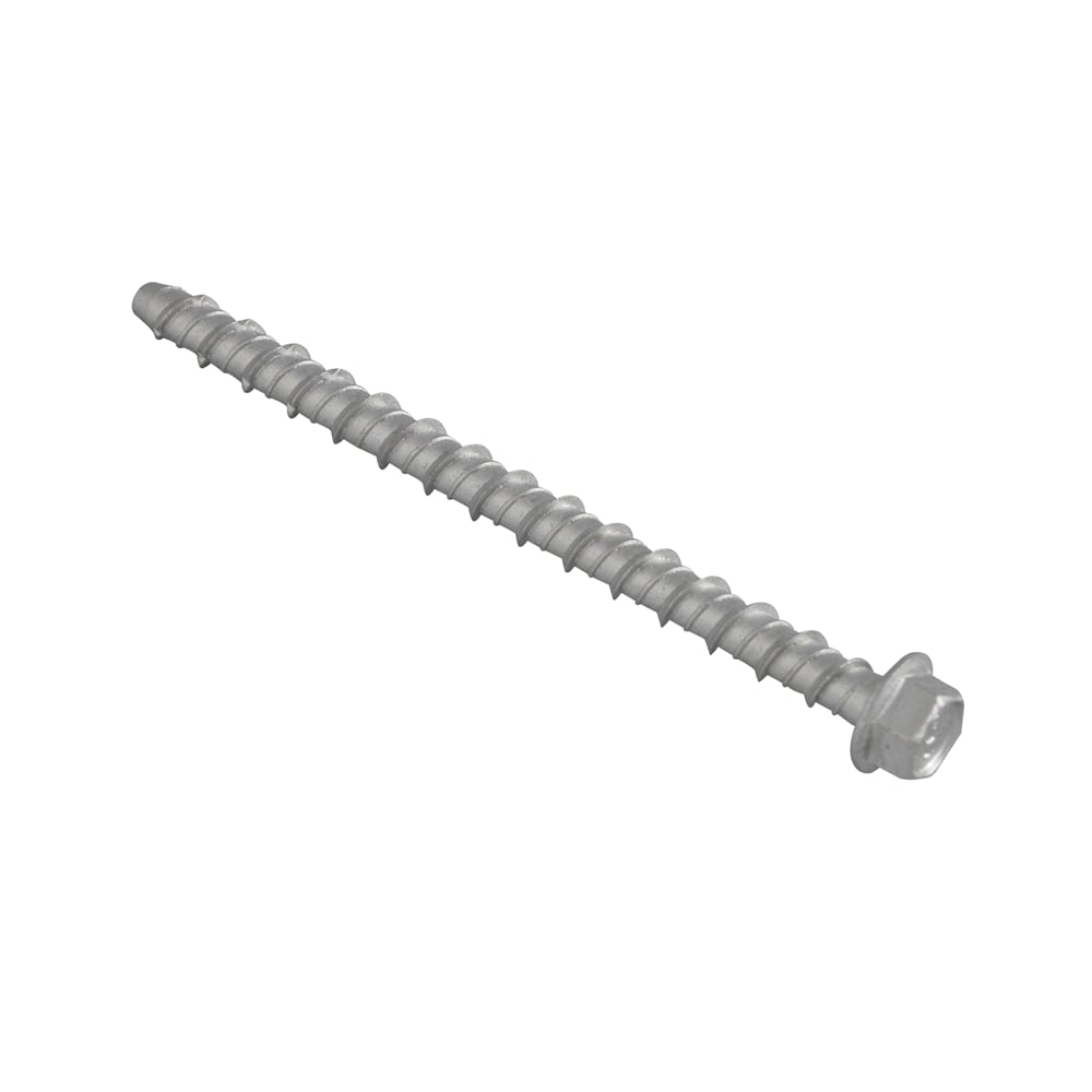

Forgefix Hex Flange Head Lightning Bolts provide a virtually stress-free fixing for close to edge applications. They are self-threading and allow quick and easy installation of most masonry fixing applications. They can simply be screwed into a pre-drilled hole, without the need for a sleeve or...
Living In the UK I first came across these useful fasteners in a local builders merchant, they are an alternative to the normal expanding bolts that often come with larger CCTV cameras. I'm sorry I haven't got a USA source but there might be an equivalent. Here they are called Forgefix Lightening Bolts, they are tough self-tapping bolts and I've been using them to make a fastening for a PTZ junction box mounting into brick. A pilot hole is required with a masonry drill, in my case most of the cutting today was with some normal 6mm masonry drills that I had, then a USA Milwaukee 0.6mm 150mm drill I'd specifically bought for the hole depth that I needed to make. The brick I was drilling into was incredibly tough, the 4 holes took me well over an hour, perhaps longer. About every 20seconds I'd cool the drill I was using in a wet cloth to prevent the drill getting too hot, up a ladder at 2nd story level wasn't pleasant.
Once the holes were made it was no sweat to use a 10mm socket and ratchet wrench to finally screw and fix the junction box onto the wall where my PTZ will go. I happen to have a torque wrench I've used for my cycles but it wasn't really necessary if you go carefully with the final tightening.
The big plus of these fasteners is that they are removable. I was disappointed when installing some wooden gates a few years ago, helping my son to increase his security after a theft, that I couldn't remove the expanding bolt fasteners I'd used when then I wanted reposition where the gate would go.
The web link I've included above is one I found just for this posting, the one below later. There are a number of UK search hits for these fasteners, I've no idea how worldwide they are available, but they certainly should be.
