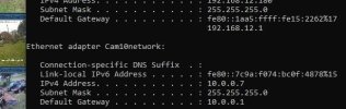

I think it is time for a diagram of your network because something isn't right.
If your BI computer and cameras were all offline and not connected to the router in any form or fashion (wired or wifi), then the cameras would still work on the BI computer.
Or are you saying you could view things on other devices because your BI computer connects wirelessly to the router, but all the cameras go from a POE switch straight to the BI computer?
If so, then you likely have the wifi adapter in the BI computer on a different subnet than the router, and plugging in to the POE switch then gave it another access way.
OR as I said originally, you thought your system was isolated and it wasn't and the router is actually routing the cameras thru.

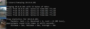

Use tracert from the BI machines to see if it can trace route to the IP cameras ..
somehow I am guessing a route / gateway setting issue here

If I am understanding your initial post, in your "offline set-up" the PoE switch (hosting the cameras) is connected to the BI machine via an ethernet cable?
Does your BI machine have a second Ethernet card, or wireless network dongle/card to connect to your router?
