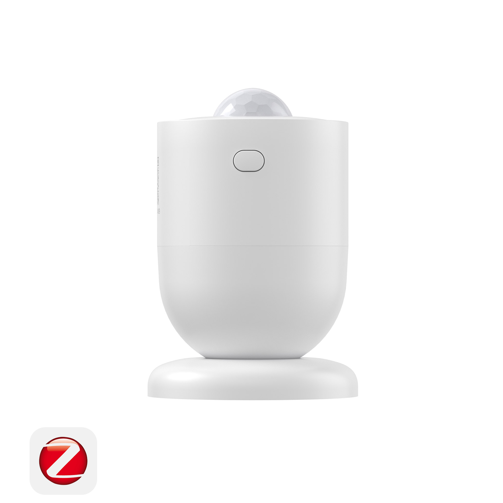

I have a rat problem near the house foundations.
The correct way to handle this is to seal all entry points, however, this is an old house with a lot of cracks ant sealing all of them will cost more than I want to invest.
I placed a few traps and rat poison in the area where I suspect rat activity and sealed a few old unused sewer pipes (that was easy to seal).
I also placed a Zigbee PIR sensor, to get notification when something moves there.
I rarely get notifications, but when I do, I don't know what moved there (maybe a cat or a rat or something else).
I don't want hardwired camera there, since 95% of the time, I don't need it.
I'm looking for PIR activated IP cam, with sd card and WIFI based.
I want it to be battery powered, this way, the camera will sleep 99% of the time and when there is movement, the camera wakes up and takes a snapshot (possibly send me the snapshot).
Is there a recommend camera for such setup?
Instead of battery, I can manage with solar panel, in case I can place it about 6m from the camera.
You may have to work with an external PIR sensor with high sensitivity and adjustable settings so you could "tune" it to reliably detect critters as small as rats....the ones I know of that have built-in, supplemental PIR detection are designed for big human critters.

Maybe use a camera that can be triggered by an external sensor, such as the Zigbee you have that does pick up rats. :cool:
It's an option, but it means the camera needs to be awake to handle the snapshot request.
Also, the latency maybe an issue, because the rat maybe out the frame until I send the "snapshot" command.
The zigbee device cannot talk directly to other none Zigbee devices.
AFAIK, there are no Zigbee cameras.

Oh, well. I've been using Shelly wireless switches; they have some with dry relay output, no hub or cloud needed, connect to 2.4GHz Wi-Fi, can send HTTP API commands to my cams over the LAN. :cool:
Reactions: looney2ns
The problem with Wifi is battery life, the PIR sensor I've mentioned claims to have 5 years battery life.
How long before you need to change battery on your WIFI switch?
