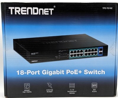

If you have the knowledge & resources, you certainly could provision a single managed switch into multiple VLANS, use two NIC's in the BI machine and keep the two networks separate. However, if the one switch fails... everything connected to it stops, as well.
Instead, many here will use several smaller switches, and if one fails... significantly less chance of 'everything' ceasing operation
Reactions: TonyR and TobiasF
I mean..... I have a 48 port Ubiquiti POE managed 500w switch with different VLAN's.
If that fails, I have more concerns to worry about than network security.
While I agree different purposed switches for backup purposes is great... can only go down the rabbit hole so far.
Reactions: TobiasF
A very nice switch but it's UNmanaged ....the OP is looking for network device isolation using VLANs other secure, workable methods......:idk:
Yes, exactly.
