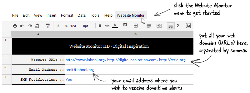

Hey Everlasting G - I took a quick gander at the code - it's written such that it appears that it can be started multiple times. That is, if you happen to click on "Website Monitor", then "Step 1: Initialize" - that actually starts the monitor running. If you subsequently (after clicking on Step 1: Initialize) click on "Step 2: Start website monitor" without an intervening click on "Uninstall", then it appears to start the monitor twice. Since the status 'toggles' are kept in a db, it's stepping on itself causing the down, up, down, up, etc. That's my theory anyway after a 5 minute look.
Try this:
Exit out of the spreadsheet if you have it open.
Get back into the spreadsheet.
Enter in your site address and email (if not already present)
Click "Website Monitor", then click on "Step 1: Initialize"
DO *NOT* CLICK ON "Step 2: Start Website Monitor"
It's a bit confusing as it is worded, but evidently the "Step 2: Start Website Monitor" is there to restart the monitor if you've clicked Uninstall and want to start it back. At least that's the way it seems to be working out at this point.
I did the above and it appears to be behaving better (only run for 30 minutes, but no false alerts yet).
Could be a simple matter of confusing "steps" in the Website Monitor Menu.
Will report back tomorrow.
Also, does anyone know a quick fix for getting the date/time displayed in the spreadsheet for a specific time zone?
Try this:
