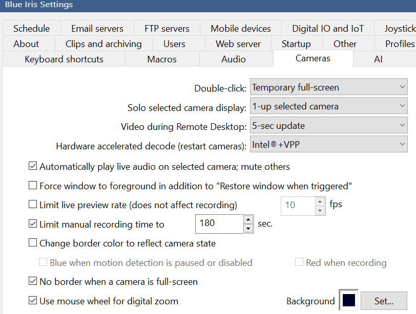

I can’t seem to be able to change the background color for UI3. I would like to change it to better make the background color to blend in with the rest of the cameras.
I‘m sure it’s user error, but would like some help.
Thanks
If you mean the background between cameras when streaming a group, I don't know of a way to configure that. It is part of the video stream that is sent by Blue Iris, so if there is a setting for it, it sure isn't in UI3.
Reactions: SouthernYankee
Bottom right in the below screen cap, "Background" Set.
