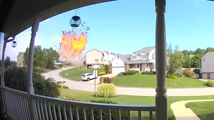

I've never seen such a thoroughly and instantly destroyed house. Meth lab? That was so destructive it seemed intentional.

Too early to make a determination....but one can speculate...Yeah the explosion on video looks so powerful.....

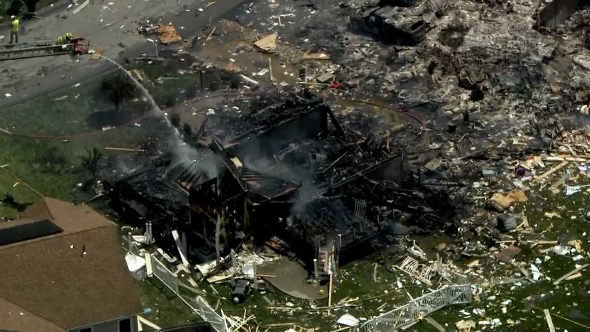

3 died, 39 house's damaged, 11 became uninhabitable.
That explosion was huge. While I have no experience with meth labs, I have to assume that wasn't the cause of this explosion due to it's size. I think it will come out that it was a gas explosion.
The other two houses seemed to have burned down by fires caused by the explosion, so hopefully all of those residents were able to evacuate safely before the structures were lost.

Reading the article in the 2nd link, I'd say the couple that died in the source of the gas explosion were overcome by the leaking gas, even though Mercaptan odorant was found, and were either unconscious or dead at the time of the explosion.
Meter data showed a sharp increase suddenly 2 days prior to the explosion. What sounds fishy to me is "....the leaking gas line was found uncapped, with the valve in the open position.”
Suicide pact that was meant to kill only the couple and not blow up the neighborhood or ???? :wtf:

Yep, there was LOTS of conjecture as to what went down with the gas line. They couldn't prove anything other than "gas leak" as there was not much left to examine.
A house right behind the one that blew, is still waiting on insurance so they can begin repairs, as the estimate is $287,000 for repairs.
I've seen a video of the damages in that house, and to me, it screams tear it down and rebuild.

I looked up video of other natural gas explosions, and they look similar to this. Didn't realize they were so devastating and created a fireball like that.
One article mentioned a problem with a water heater, but if one ruptured, it would probably put a hole through something but not blow a whole house up along with a fireball.
I'm going to say gas leak, although I wonder exactly how much gas is required to do that, and how it goes undetected. I've had miniscule leaks, and I can still smell them.
My BBQ had a tiny leak outdoors, and I still was able to smell it. In fact, I sniffed each connector until I isolated the one that was leaking and then reapplied the pipe tape. Apparently reusing the existing tape isn't good enough. Lesson learned.
Don't know what sort of leak it would take to blow a whole house up and destroy the neighbors though.
Given enough time, a slow gas leak can form a VERY large volume and when ignited, produce an explosion such as we've seen in PA. I've known of several in my lifetime of that magnitude in residential houses.
Certainly I'm not a qualified CSI-type, just a regular guy who's paid attention a number of years, so here's my take on this explosion:
  • There's a gas leak, small but just enough to fill up a living space in only a few hours.
  • Occupants are asleep and are asphyxiated, are likely dead before the explosion.
  • The large volume of collected gas reaches a source of ignition.
  • Boom!
Yes, that's an over-simplification and there are still many unanswered questions, none will revive the dead but it may point to homicide or a suicide pact......or a terrible and unfortunate accident.
Hopefully, more time and close inspection and theorizing by the investigators and they will come up with some viable answers.

I've run black pipe in 3 houses now. I'm experienced in fixing my mistakes. None of them would have resulted in leaving a creator where my house once stood no matter how long the leak went undetected. Houses simply aren't sealed so tightly that a small leak will cause an explosion.
My sense is it had to be a massive leak.
