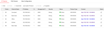

I have a hikvision NVR with 5 POE cameras connected to it. The NVR has the IP Address of 192.168.1.102 and the cameras are designated a new IP address because of the way they are connected, however, I know I access the cameras by using rtsp user
ass @192.168.1.102/Streaming/channels/101 or 201 etc (and I took the colon and forward slashes out just in case!)
