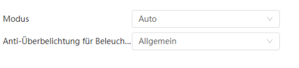

C Chokolinho Getting the hang of it Jul 15, 2024 202 62 Germany Mar 9, 2025 #21 During the day it looks like this. Is there anything that could be improved? Attachments 01a8099a41a56b754a8904b71a4cd518 (1).jpg 567.3 KB · Views: 0 01a8099a41a56b754a8904b71a4cd518.jpg 567.3 KB · Views: 0 30f9b2d8c79725cc9c2ea3734c99e784.png 15 KB · Views: 0 Last edited: Mar 9, 2025

steve1225 IPCT+ Member Apr 11, 2020 1,460 1,835 Poland/Portugal Mar 9, 2025 #23 rotate camera to the right.. too much walls and too much reflections from them... Reactions: bigredfish and Chokolinho
MikeLud1 IPCT Contributor Apr 5, 2017 2,484 4,592 Brooklyn, NY Mar 9, 2025 #24 steve1225 said: rotate camera to the right.. too much walls and too much reflections from them... Click to expand... I agree rotate the camera to the right and down like below Reactions: bigredfish
bigredfish Known around here Sep 5, 2016 25,989 68,819 The Swamp Mar 9, 2025 #25 I just meant the image is fine. I usually use 0-2 in daytime to allow for overcast days. And yes, the less wall and roofline as both of the above posts say would be better.
