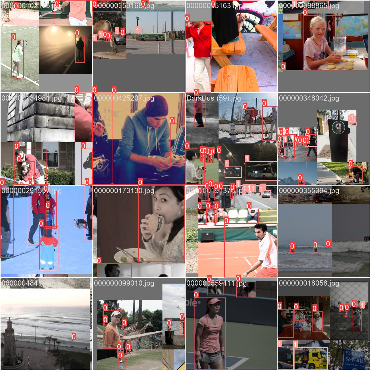

I normally train with a 90-10 split, you do not need the validation images. you can also try training with 100 epochs. All my models are trained with 75 to 200 epochs using as much as 100,000 images and can take over 24 hours to train using a RTX 3090 GPU.
Also below is another graph to tell how well you model trained, the closer to 1.0 the better the models is.
When training you what to see the graph that are highlighted in blue going down (lower numbers) and the graphs highlighted in green going up. If the model is not improve then the best.pt does not get updated.

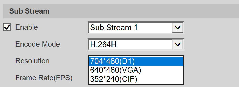

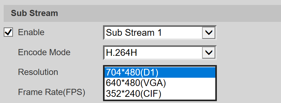

Use ether D1 or VGA for your Sub Stream. When training it does not stretch 480px it fills the rest of the image with the color gray
