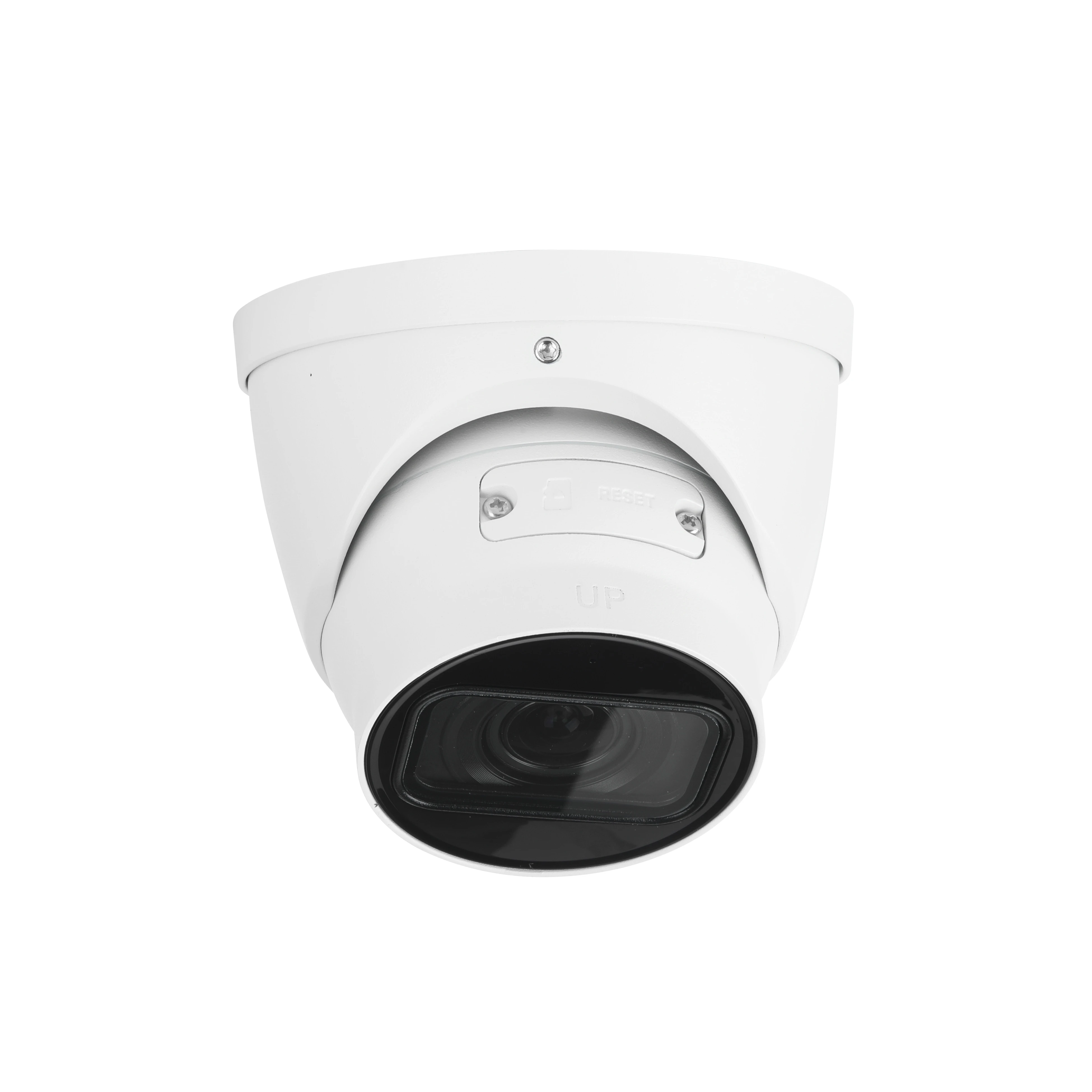

Front, Camera 1:

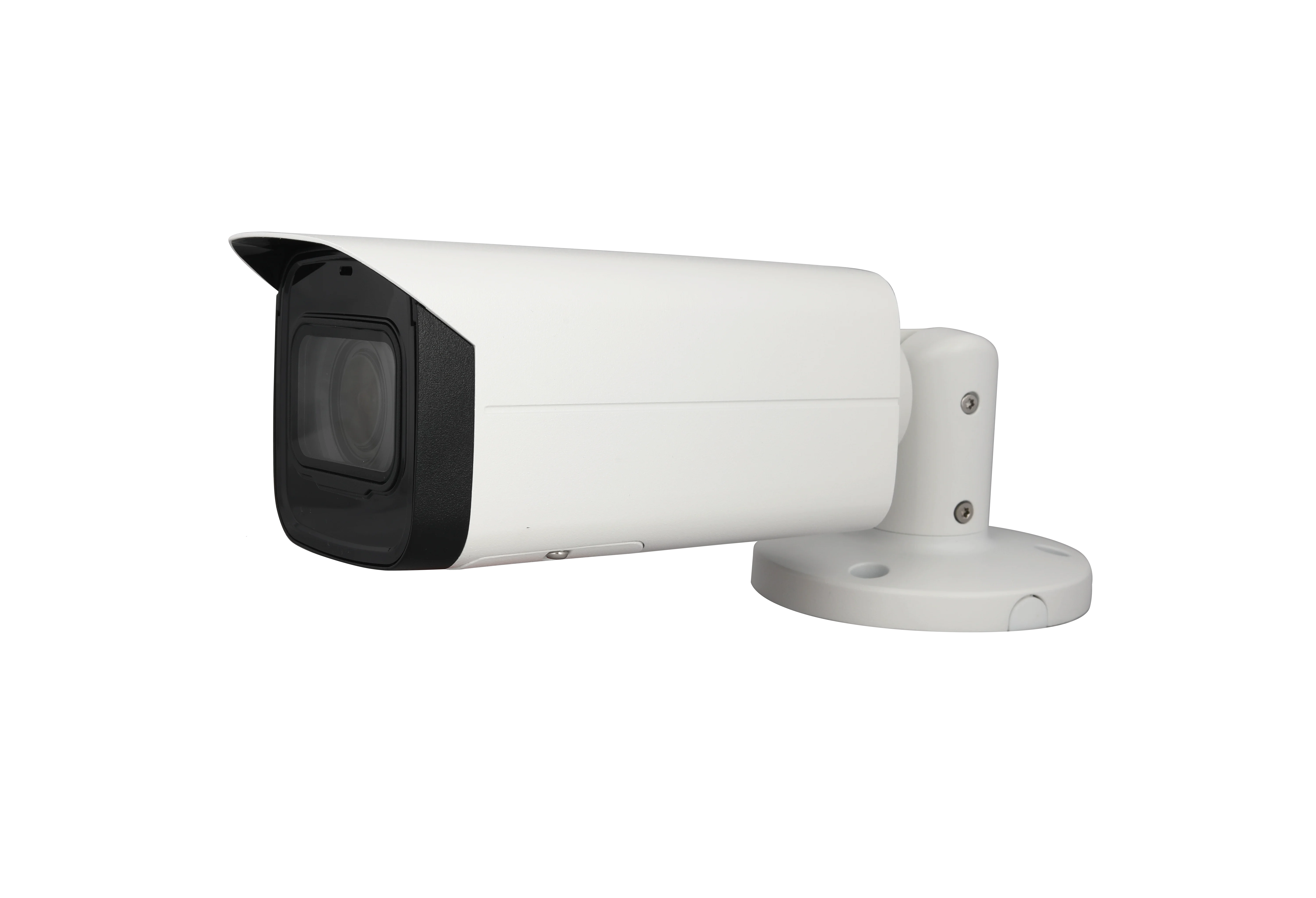

Rear Camera 3 (corner pointing along wall)
From what I understand, these are both rated Dahua cameras for low light conditions.
