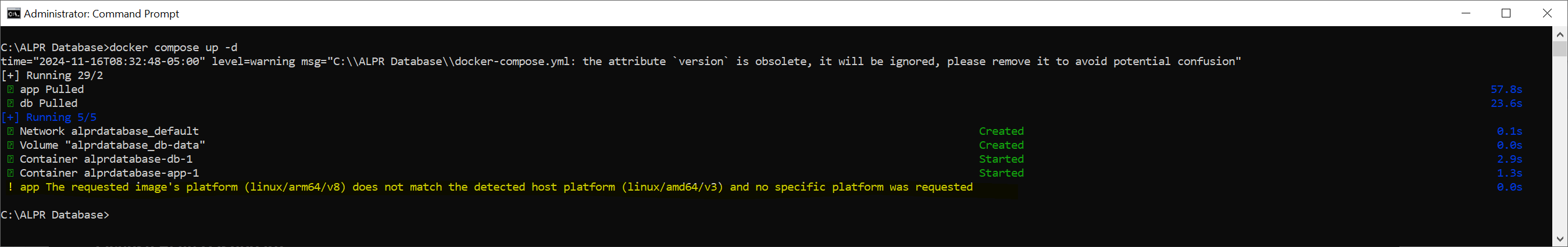

It looks like BI is sending the right data to the dashboard, but it can't write the data to the database. Did you install this with the install script? Did it give you any warnings or errors? Maybe the schema is an older version?
I followed all the directions for a new install. I didn't notice any errors. Would there be any install logs?

I'll have to tinker around with things some more I guess..... I only installed this a couple of days ago, so I presume it's all the latest... I honestly don't remember seeing any errors at all during the install. It all seemed to have gone smoothly.
