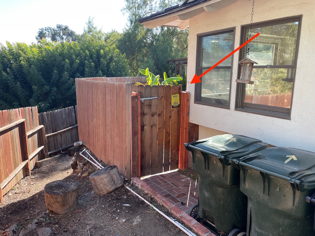

I'm going to put a camera on my back gate (again) looking outward. It'll go here, where I had my previous camera, and where I have a run of Ethernet:

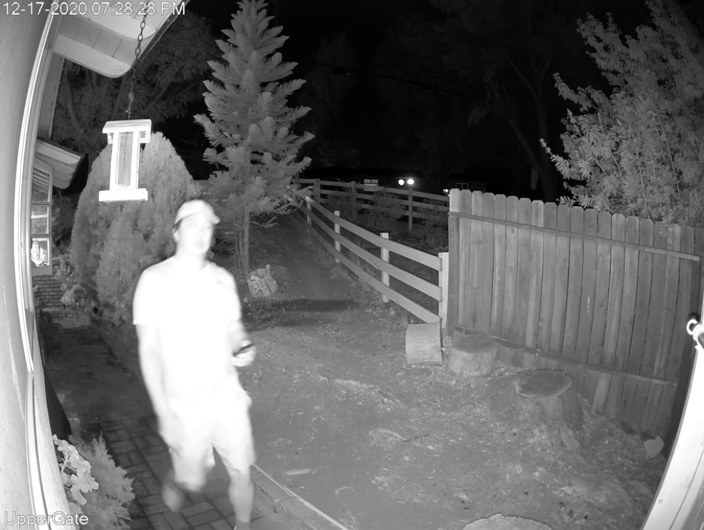

You can see the view from the previously-installed camera (Amcrest IP5M T1179EW 28MM), here:
I'm considering using a $70 ADC2W for this, so that I get a motion-triggered floodlight, both for its deterrent value as well as to light up the area for my tenant who comes through here at night en route to the guest house.
Is the floodlight going to be blinding at that height and location? Is the motion trigger adjustable? If I end up not liking the built-in floodlight, is there a known hack to have the motion trigger an external floodlight?
