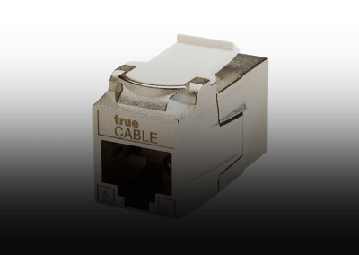

Are the female connectors available in a solder-up pigtail or am I screwed?
