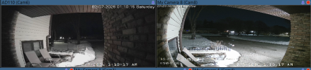

MAybe you can catch the face before the bat with a EmpireTech IPC-T24IR-AS 1/2.9" CMOS 4MP IR and if they wack it, it's only $80 bucks. Meanwhile a doorbell cam will capture the wacker doing the wacking.
or if he goes after the doorbell first the camera will capture that too. I have both.
Reactions: Mike Baglini
Here the Amcrest 5mp caught the face in the sun before the shadows obscured it. Doorbell image not good in daylight in a dark porch.1770448516459.png1770448705348.png

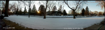

Here is an 4MP Color4k t180 with warm white LED lights and Color 4k 8mp bullet with warm LED lights in the garage. 1770449148412.png 1770449363806.png
Here is the T180 before I down- Resolutioned it to a 1080P stream, like the long strip pics above.
