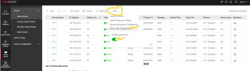

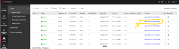

Hi, I may have the same issue where my camera alarm goes off sometimes at random times. I went to NVR configuration and don't have anything in there to cause this. How do I get into the camera web menu? would I get its ip address in the NVR?
You need to turn on "Virtual Host" on the NVR... then you will be able to access each camera's web GUI using the links under the "Connect" column, or by typing the virtual host camera address in your web browser (like http://<NVR IP Address>:65002 for the camera on PoE port #2).
Here it is in V5 NVR firmware, if you have V4 or V3 firmware it will be similar in the menus:
