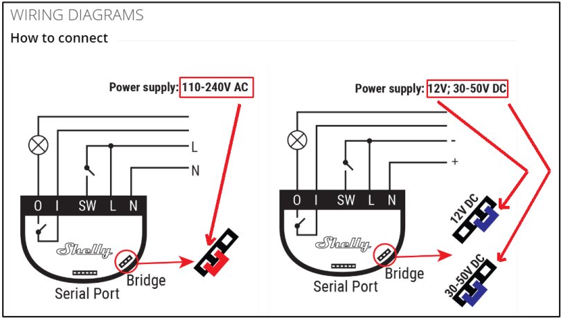

The Shelly1 can operate from and switch 120VAC to 240VAC or when properly configured, 12VDC or 24 to 50VDC. The relay contact inside the Shelly1 is a ‘dry’ contact, meaning it can switch DC or AC loads up to 15A @ 240VAC. Note that on the input, the switch will apply the same voltage that is applied as the device operating voltage. It should be no problem to operate the coil of an external, higher current relay or contactor with it. However, if you do that I would consider a Quencharc® (an R-C snubber) across such an external relay coil to suppress EMI and voltage transients generated as the field of the coil of the larger, external relay collapses.
I like the fact that I can choose to operate the device on 12VDC, including the device I’m switching. If you’re like me, you likely have a small 12VDC wall wart for an IP or old analog camera around that will power the Shelly. Refer to Figure 1.

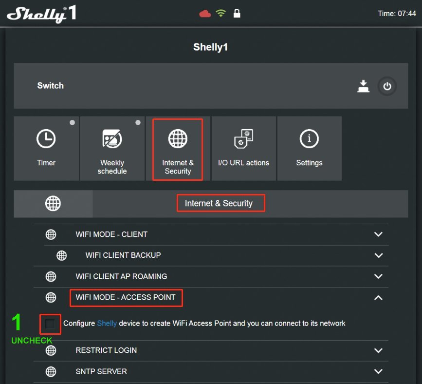

Assuming you want to bind the Shelly to your local Wi-Fi, first log into each Shelly, go to “Internet & Security”=> “WIFI MODE - ACCESS POINT” and UNcheck “Configure Shelly device to create WiFi Access Point and you can connect to its network”. Refer to Figure 2.

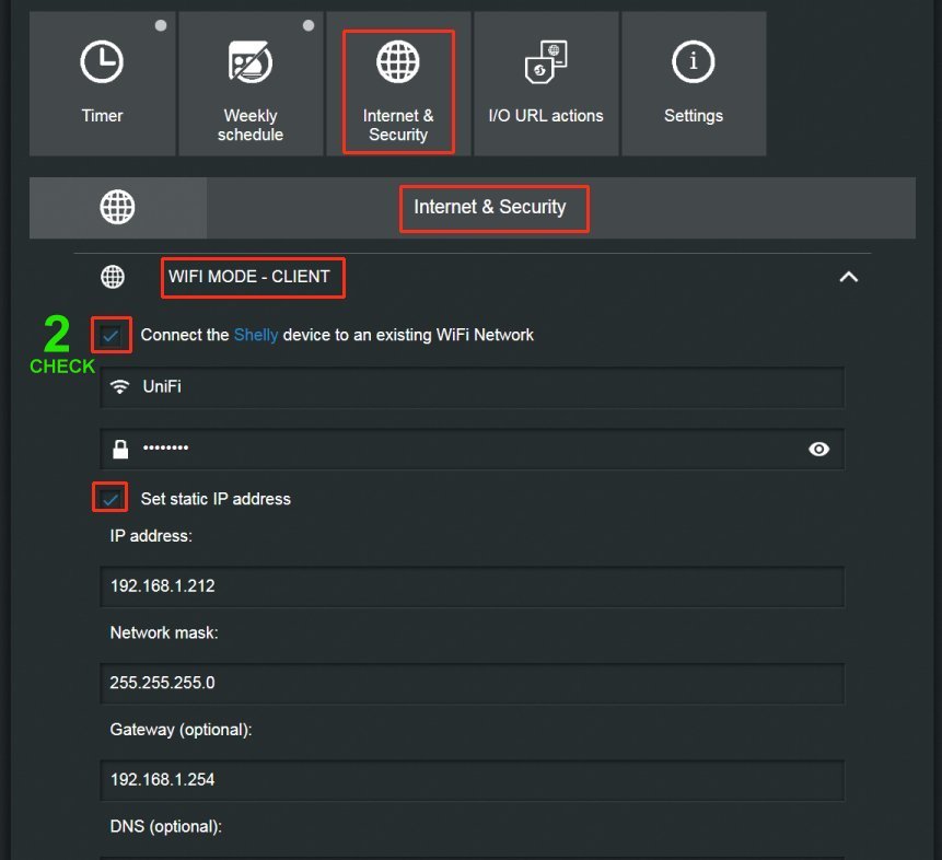

Next, go up to "WIFI MODE - CLIENT" => "Connect the Shelly device to an existing WiFi Network", type in your local Wi-Fi’s SSID and password, assign each Shelly a unique static IP in your LAN’s subnet with subnet mask of 255.255.255.0 and click on “SAVE”. Refer to Figure 3.
Return to the wireless NIC network settings of the device you used to log onto the Shelly when it was in AP mode and broadcasting an SSID, change the device’s IP from the static 192.168.33.3 back to what it was.
Now open a browser, type in the IP of the Shelly you assigned it and if all was configured properly the webGUI of that Shelly should open. From this point forward you will open a browser in this manner to perform its configuration.

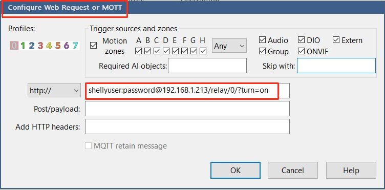

Under “Action Set”, click on the “ + “ button to create a new “Web request or MQTT”. For the HTTP to be sent to the Shelly1, enter its username and password (if configured), its IP address and the rest of the URL as in:
Code:
“username:[email protected]/relay/01/?turn=on”
Then click on the “OK’ button to save.
Refer to Figure 6.

Create a new “Web request or MQTT”; for the HTTP to be sent to the Shelly1, enter its username and password (if configured), its IP address and the rest of the URL as in:
Code:
“username:[email protected]/relay/01/?turn=off”
Then click on the “OK” button to save.
Refer to Figure 7.

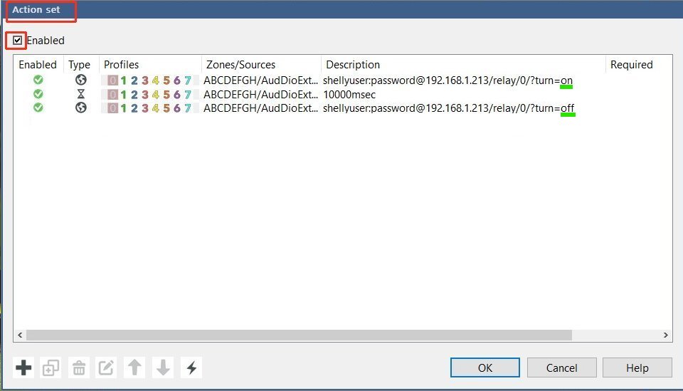

You should have 3 entries under “Action Set”:
#1 (first) is a “Web request or MQTT” to CLOSE the Shelly 1’s relay and turn the lamp ON.
#2 is a “Wait’ action for 10,000 milliseconds.
#3 (last) is a “Web request or MQTT” to OPEN the Shelly 1’s relay and turn the lamp OFF.
