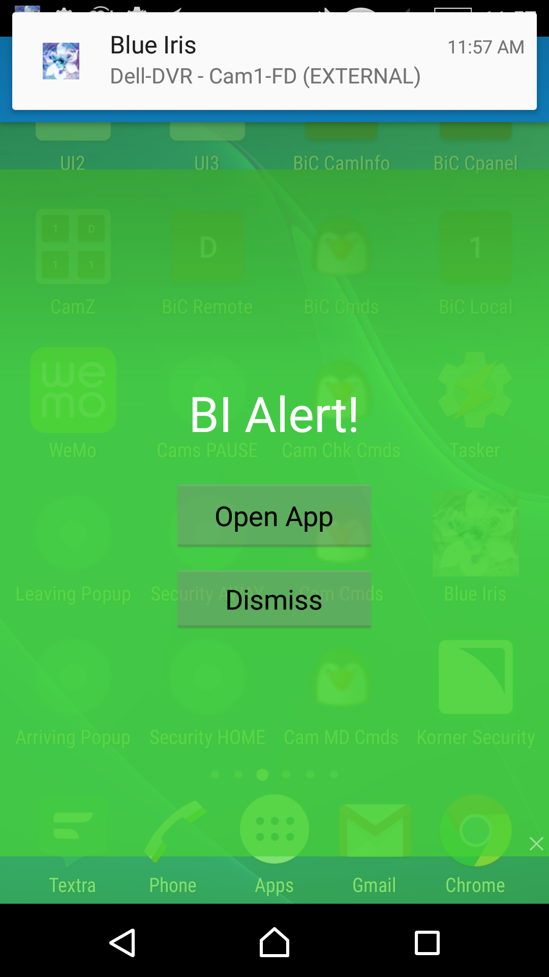

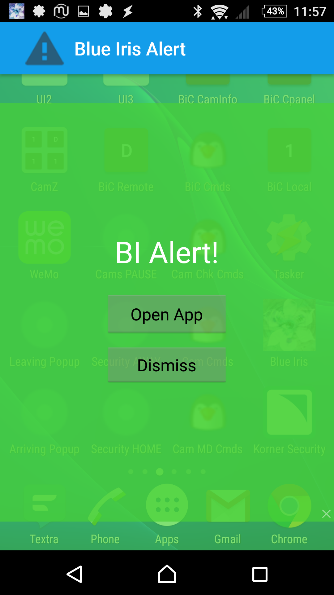

Here's a DEMO... the screenshot below shows the result of AutoNotificaton intercepting an incoming Blue Iris App notification on my device. At the top of the screen you see the BI App's originating heads-up notification. Under it you see Tasker's response -- a custom Tasker 'Scene' (green with action buttons).
In this demo, I've made the Tasker 'Scene' "persistent". That is, it remains visible even after the BI App's heads-up notification has gone away. This ensures I don't overlook the notification. In fact, it is still there, big and bold, even if the phone's display has turned itself off and I've just turned it back on. (The BI App's original notification remains in the phone's notification drawer).

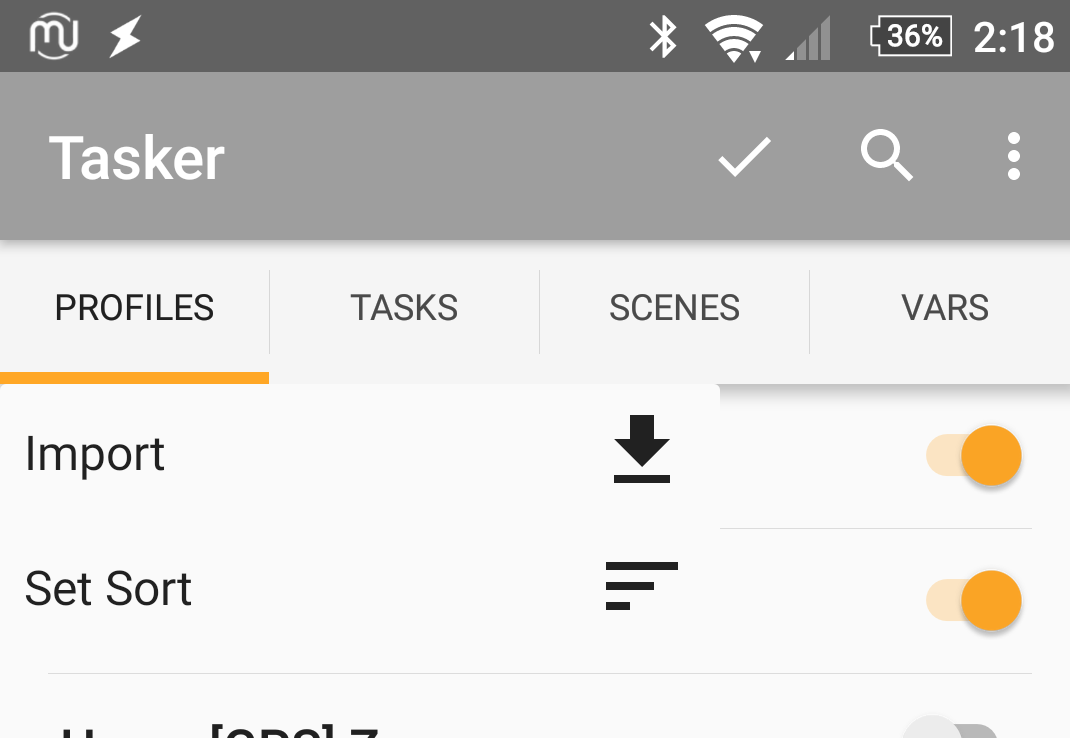

After you have installed the AutoNotificaton plugin, you need to import these transferred files into Tasker. First long-press on the 'Profiles' tab to expose the Import menu (see image), then navigate to the 'source' folder to select imported file. Then repeat 2 more times for the 'Tasks' and 'Scenes' tabs.

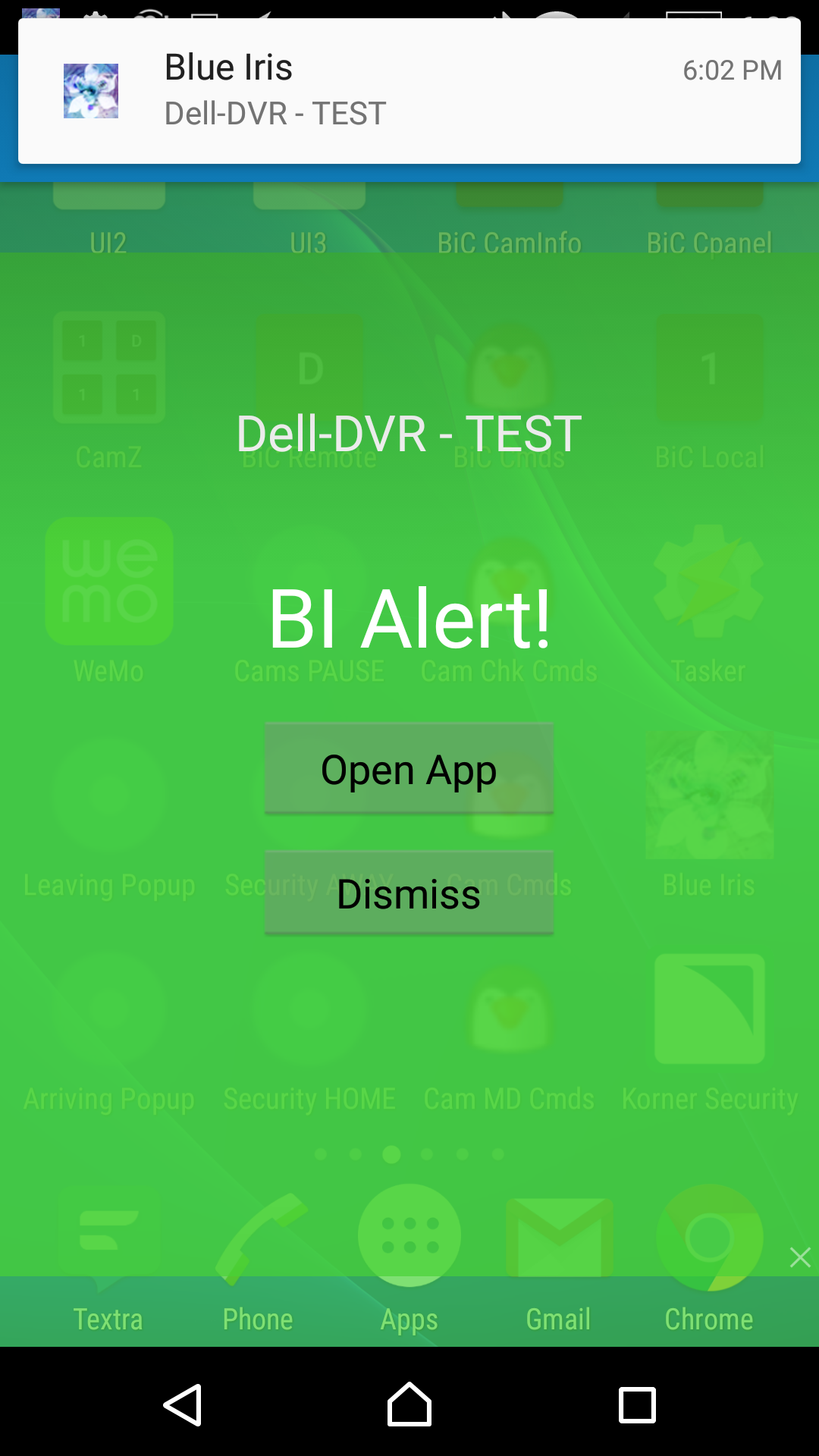

I tweaked the demo a bit today... the updated zip file and demo image are attached.
The 'Task' and 'Scene' now "read" and reuse the text from the original Blue Iris App notification.
The AutoNotification plugin makes this property (and many more!) available via Tasker variables (in this case the variable is %antext).
One further note... You can send test notifications from Blue Iris via this dialog:
click Camera properties | Alerts tab | Configure button (next to 'Send a push notification to mobile app') | Test
