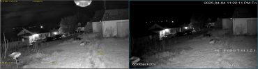

Here is a comparison.
Here is at a total dark spot and only infrared from the camera
2MP on the 1/2.8" sensor at 1/60 shutter at 385 feet:
4MP on same 1/2.8" sensor at 1/60 shutter at 365 feet (camera is 20 feet closer):
Ideal MP/sensor ratio's are important for any camera, but even more so for a PTZ that see's a wide range of distances and lighting conditions.
And 4MP on the 1/1.8" sensor will blow away any 2MP on the 1/2.8" sensor.
Think there are some important things missing here.. Because I have a couple PTZs that are on the same sensor 1 is 4mp and other 2mp and the 4mp has a 4.8mm to start with the 2mp having a 4.7mm to start one is 25x the 4mp and the 2mp is 20x.. So I can tell you for sure that the 4mp after the last update has a better picture and no blurring with motion for the most point of the zoom range. Only thing that the 2mp does better now then the 4mp is zoom at distance because of the quality IR with zoom that the 2mp has that the 4mp don't. However if I zoom my 2mp into the same area as the 4mp and it uses that IR the 4mp again out performs the 2mp..
So there are a lot of factors that come into play in the case of my 1/2.8in sensor cameras.. Software is some of it as much as I hate to say that because I know there are some cameras out there that bloat software and have very bad motion blur. I just reset this back to factory so they are at the current default settings and hate to say it because of my 4mp I no longer like the company because they keep breaking things after every update and they won't send me the last FW to have functions back lol.. Only added in the Overlays didn't' change any other settings.. Clearly the 4mp has a better picture.. Even with 2mp camera in the way lol.. So my guess is it might be even better if there was no reflection of the IR off that camera. I know the camera is black and dull at that so reflection should be minor.. Anyway..
As much as it pains me to say it my 4mp camera now has better picture then the 2mp it wasn't that way for the first 3 years owning it lol. It wasn't until last July update that the picture was better.. I did make a video of it some time ago. Shortly after that video there was an update lol.. Just saying..
