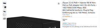

I currently have ports 1-5 normally occupied by cable. I would like to install three more cameras upstairs, but there is only one cable there and I can't get another one through. I have connected the devices as follows.
NVR Poe Port 6 -> 90W injector -> Poe extender 90W -> 3 cameras = Only two cameras are found and working. Am I just too stupid?3b67ce55e226cdfc6f32fdf98cbd1ffe.png03933e0a30014f7f97579c52dd300e1e.png
We have told you in your other thread this will not work connecting to a POE port.
You need a regular POE switch connected to the WAN/LAN of the NVR.
Sometimes connecting to an NVR POE port can find 2 cameras, but nobody here has ever posted more than that.
