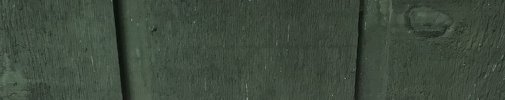

It is not thick, maybe a bit over 1/2" or so. Behind it it is open except where the studs are and there is no access without creating a new project. I am thinking of sturdy inserts right now. As long as the anchors don't pull out, it should be fine. I want to have the mount so I can determine its positioning and see if it lands on a stud.
Here is a cropped image of the stuff:
edit: Oh, drywall on the other side - 2 x 4 studs as a guess right now.

Most of the time they use a 4 stud corner if using 2x4. If this is the case, you will be fine using any 2.5" deck screw or even better a lag screw (like what they always include with TV wall mounts) if you are really worried. I have hung a very heavy 45x PTZ using deck screws and washers on that type of bracket. You will know right away if you hit a stud or not.

Even if the bracket goes beyond the stud usually there is 3/4 board on houses except the newer house that use the particle board. Use galvanized lag screws is what I would use. The weight will be on the top lags so if they tighten good then you will be fine if not maybe shove an anchor in then reinsert the lag screw. And make sure the threads are all the way or close to the head of the screw and not have a shaft 1/2" or more from the head otherwise it will grab less

Also, I didn't make it back with the measurement of the siding the other day. It looks like 3/4" at the thick points.
