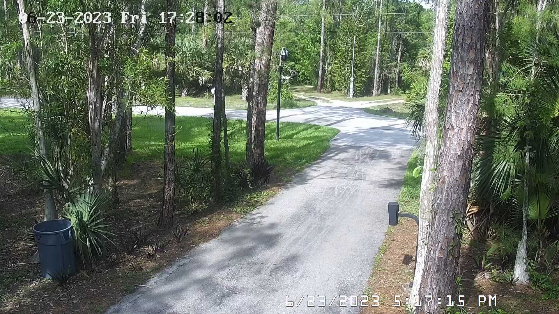

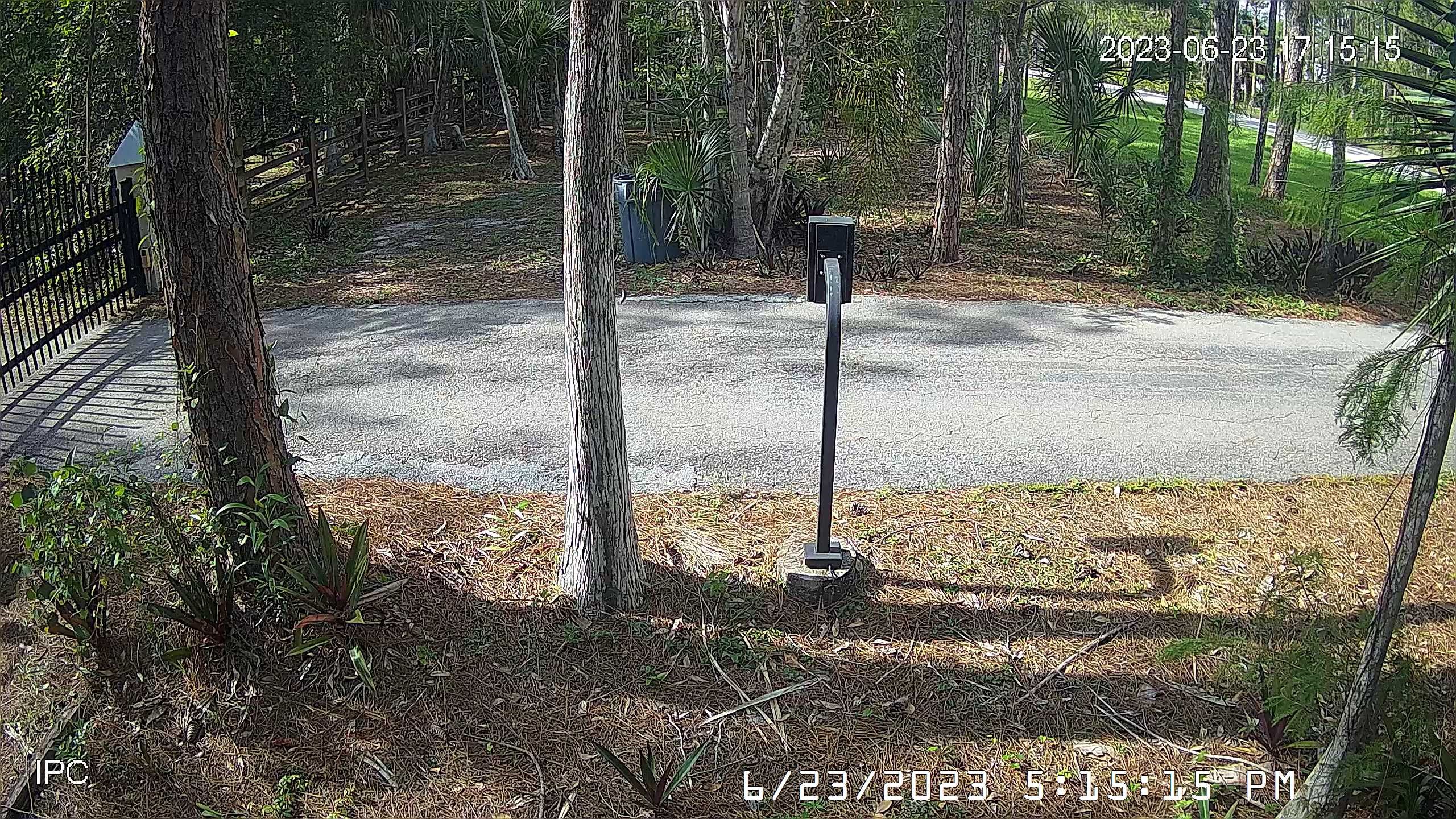

Coldair IPCT+ Member Sep 19, 2015 1,061 1,363 Naples Fl Jun 23, 2023 #1 and allowing me to trigger a dry contact to open a gate? Attachments CallBox203.20230623_171544540.8.jpg 2.2 MB · Views: 158 PZ227.20230623_171743557.9.jpg 837.1 KB · Views: 171
TonyR IPCT Contributor IPCT+ Member Jul 15, 2014 20,326 48,133 Alabama Jun 23, 2023 #2 The Shelly1-UL Wi-Fi switch has a dry contact and BI can open/close it using an HTTP command ==>> Simple Blue Iris I/O using Shelly1 Wi-Fi Devices Want wired and not wireless? Consider the Ethernet-connected Shelly Pro 1. Alert and pictures? See @jaydeel 's write up to send via BI ==>> Send Pushover notifications with pictures and hyperlinks Last edited: Jun 23, 2023 Reactions: looney2ns, JDreaming and fenderman
