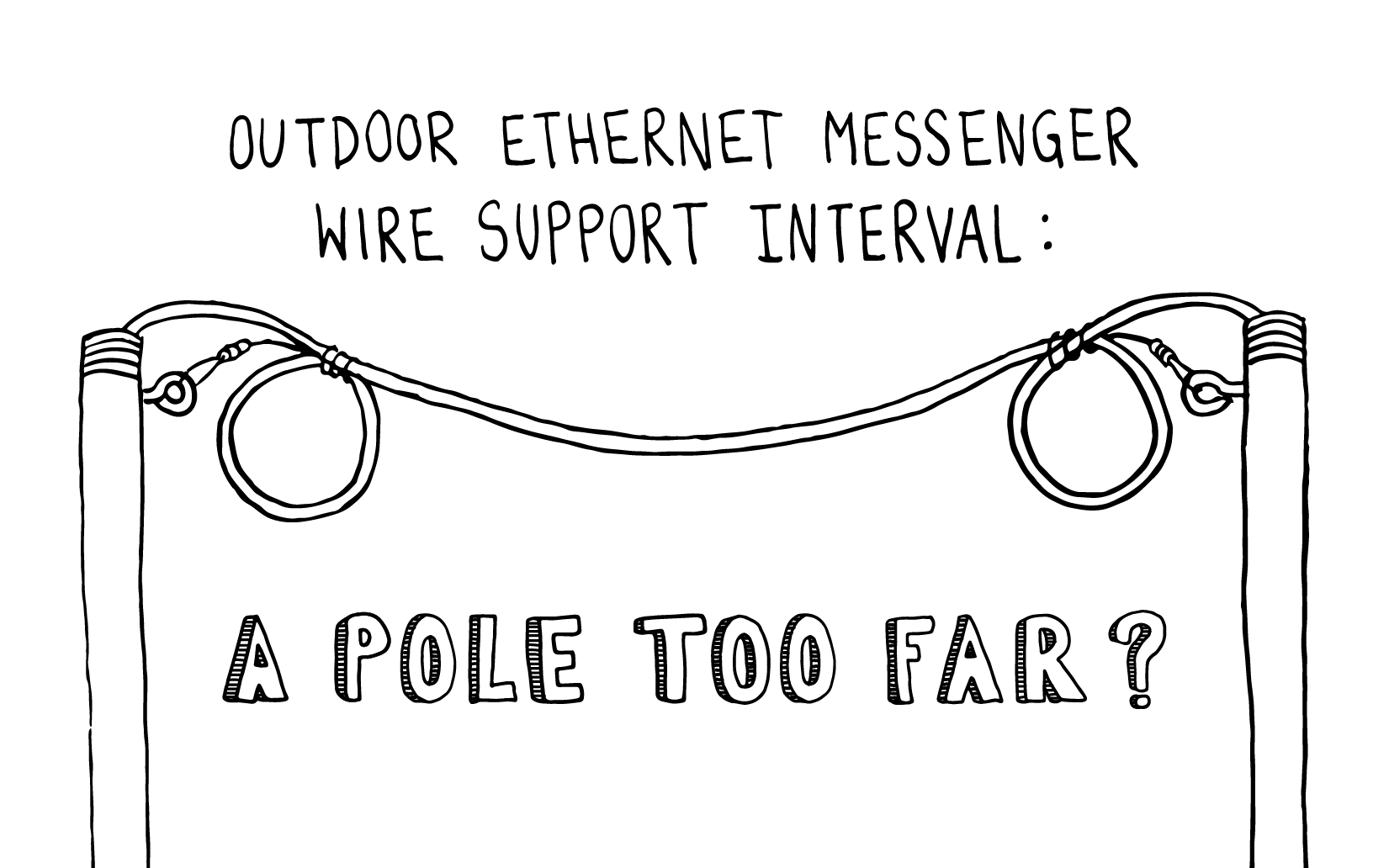

From the same site, an article and video about cable with a a "messenger wire" (support wire), which they happen to sell:
$258 for 1000 feet is less than I expected.
Yeah that's a great deal. I was expecting copper clad aluminum but it says pure solid copper core.
