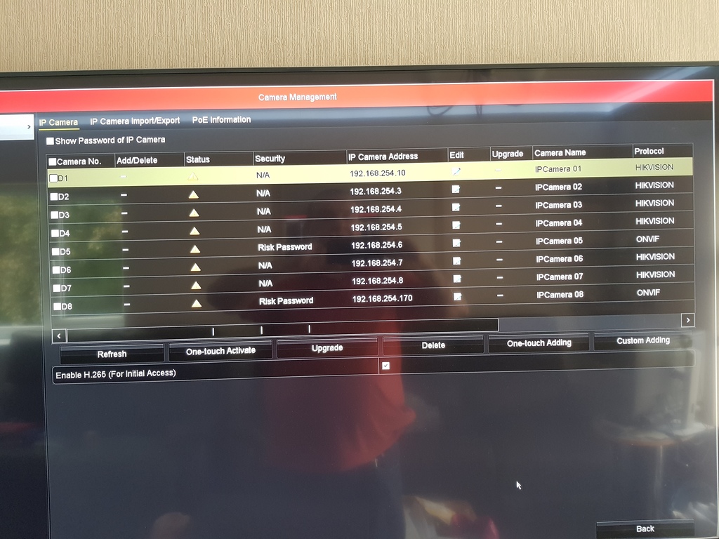

This is the camera settings on the NVR
This is the "custom settings"
This is the Network settings on the NVR
I suspect it's here that something is wrong?
Any suggestions?

You haven't done the above.
You need to set the camera IP address correctly if you are going to connect it to the NVR PoE port.
And you've shown that the 'ONVIF port' from ONVIF Device Manager is 80.
So once you manage to set the camera IP address to 192.168.254.2 (for PoE channel 1) with the NVR channel set as ONVIF it should work OK.

This is how I have it set now
It's still not working
The password is correct
I did change the rtsp port back to 554 but I'm pretty sure that's not the problem
It's really puzzling because it has to be something simple but I just cannot figure it out

Yes the IP address is 192.168.254.2
It won't connect to the pc now through the router which it did before I changed it
Getting there now :)
I found one really STUPID mistake, the network cable for the camera wasn't fully pushed in to the dvr socket
However I now have this
It proves it's communicating but I've no idea what language it means
