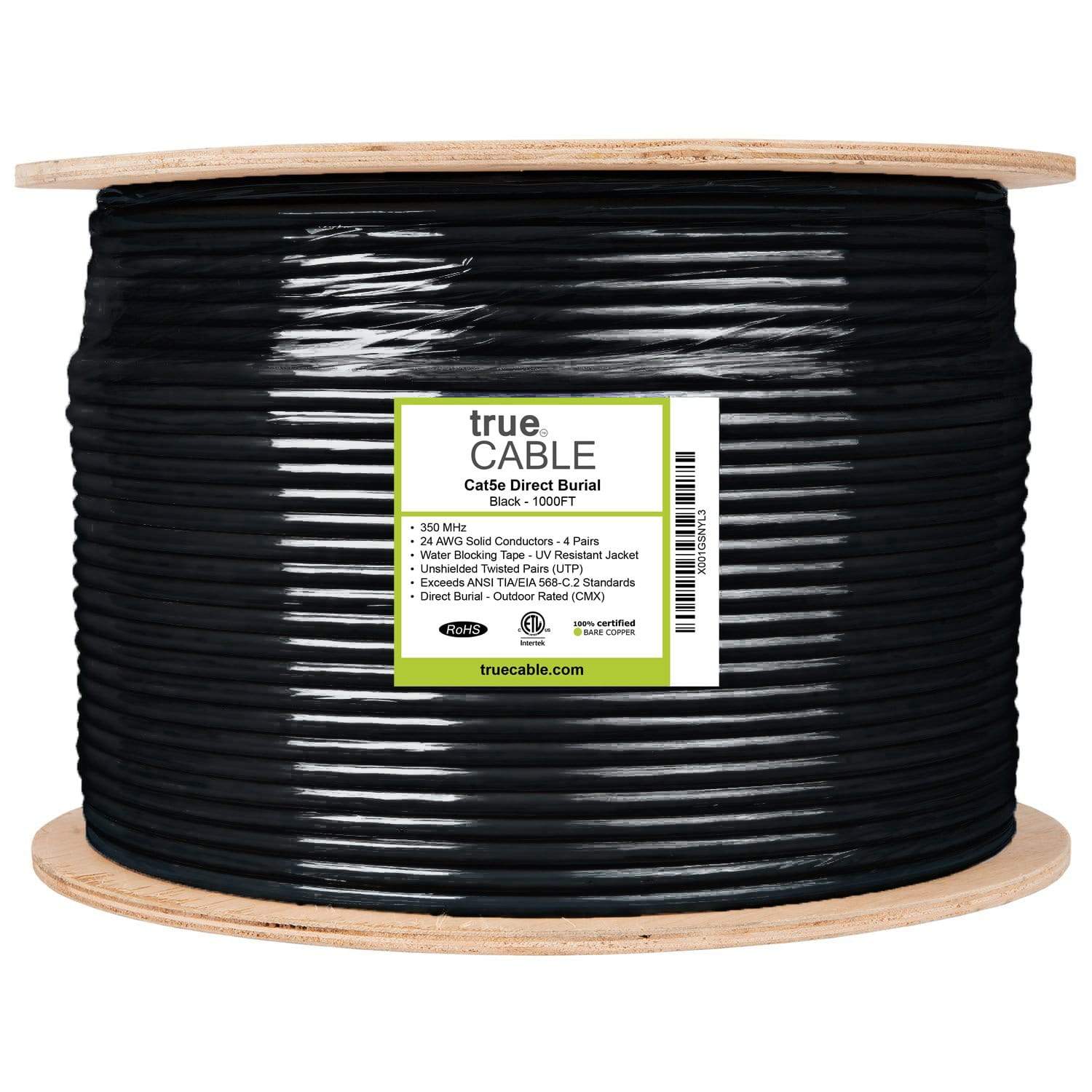

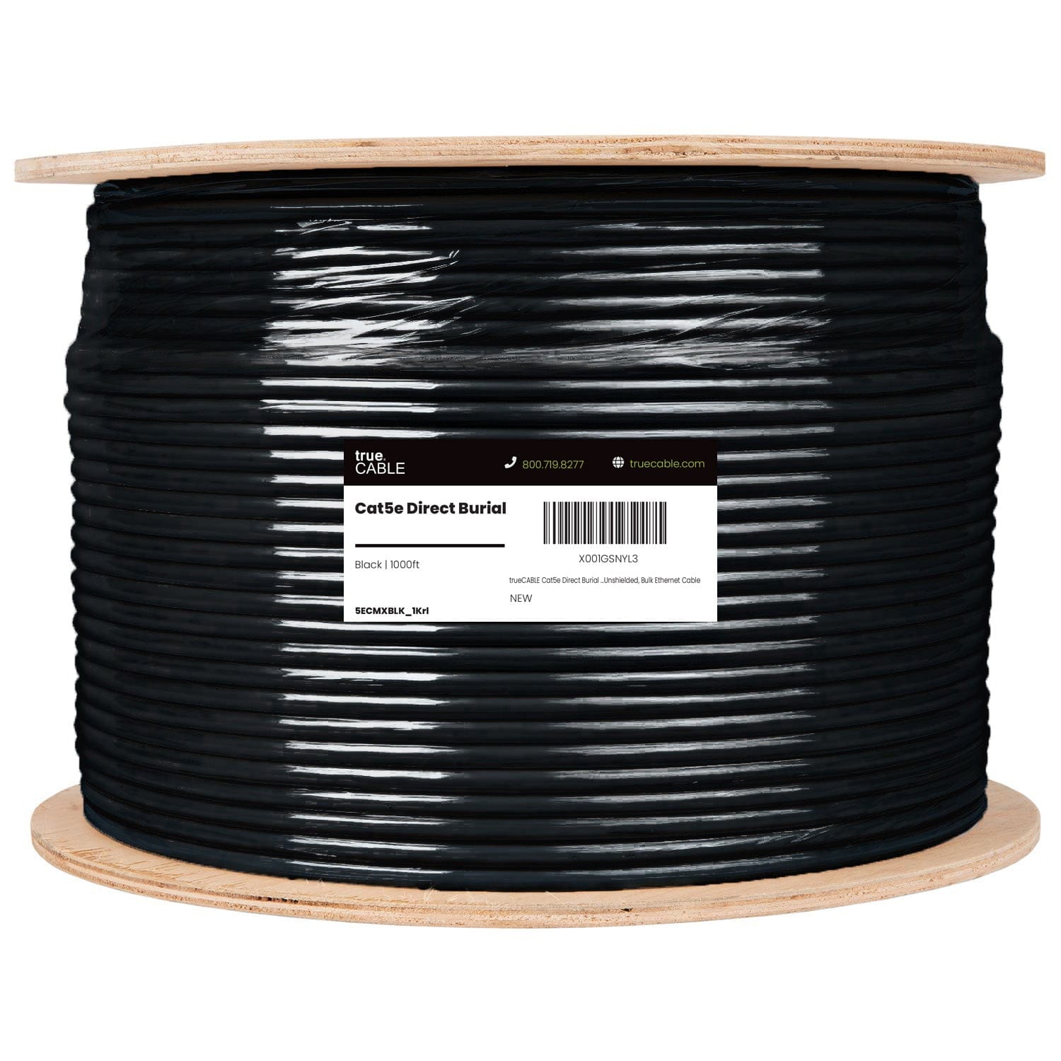

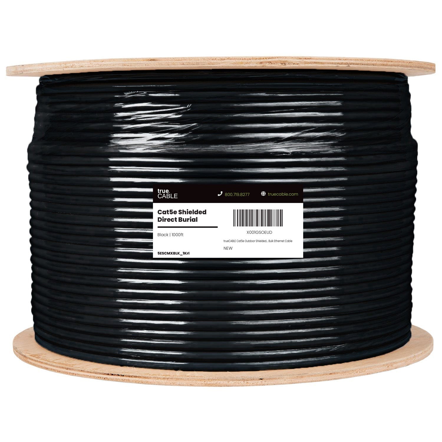

You definitely need to use direct burial rated cable and I think you should consider using 5e or 6. I know this is just an LPR but next thing you know you want to add a switch and other devices at your front yard - just a thought!

I'd still use direct burial-rated CAT cable for the heavier HDPE outer jacket it has that can better resist rocks, abrasions, cuts, etc. better than a CMR-rated PVC jacket.
