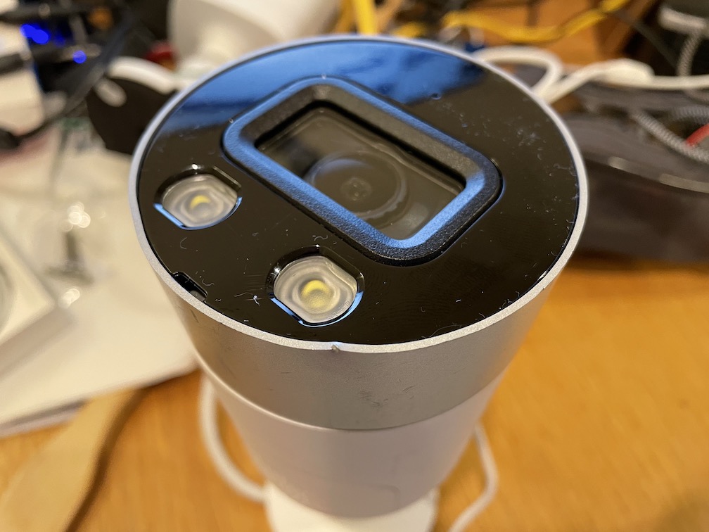

It arrived, and it's got a dent :rolleyes:
The camera seems to work fine, and I got it for $90, but would y'all be OK with a camera in this condition? The ebay description says, "Customer return. Fully tested and working. Minor scratches or small scuffs possible. Camera only"
Would you describe this as a "minor scratch or minor scuff"? I suppose I'm more concerned that the event that created this dent might have produced latent damage inside.
Also, how difficult is it to manually tweak the focus on this camera? This is going inside an OwlBox, so the objects of interest will be anywhere from 2" to 24" away, Right now anything closer than about 24" is badly OOF.
Of course I don't want to open this up until I know I'm going to keep it . . . .

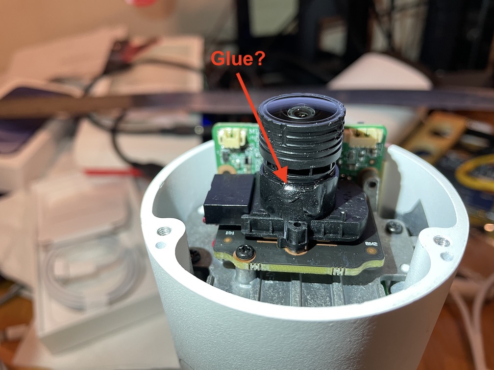

hm. if the ebay listing showed the dent already, then youre kinda stuck with it. if not, one migtht say it happened in shipping? or just live with it, if it's working OK.. the birds won't care. the big question is, how does it fit in your tube? and have you been able to focus it in nice & close like you need? it's easy on this cam. just pop that plastic cover off, 4 medium/small philips screws and viola. either scrape off the glue holding the lens from moving with an exacto, or just grab the lens with padded plyers and unscrew to loosen the glue, then remove it. you'll probably be unscrewing the lens anyways for closer focus. once focused, a dab of superglue, hot glur or bondic to keep it from un-focusing. note, you've also got a microphone to listen in. don't try pulling that cover by poking a dental pick into that hole... :)

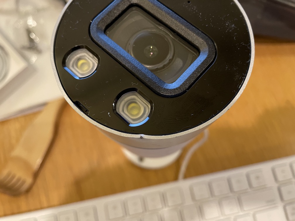

How does one pop off the plastic cover? Do I just pull? Or do I have to pry somewhere? I googled, and there are no results for "E891AB teardown" or "E891AB disassembly." In fact the first search results say, "Do not disassemble!" :rofl:
As an eBay Associate IPCamTalk earns from qualifying purchases.
you migth even be able to un-dent it a bit once you open it up. a few judicious taps with a small hammer on a forgving surface...
just pry with small screwdriver in that slot below the LED's at the bottom left of your image.

Thanks! I was totally doing it wrong. But now I have it open.
Is this the glue that I need to break?
