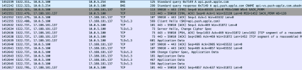

The log shows that push notifications are being sent successfully -> Push: OK to iPhone (0/482)
I even monitored the BlueIris server traffic with WireShark. I found that a connection to the Apple servers is actually being established. Unfortunately, no messages are coming through:
Do you have any idea what could be causing this?
