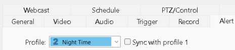

I just came back to Blue Iris after 2 years. I remember when I used BI last I could open the IOS app and change my profile from away to home so I could stop notifications coming to my IOS device. I know I can use AI but I haven't done that yet.
My question is now if I do that and change it from away to home I still get the notifications. What setting am I missing? I see under settings then devices my IOS device is listed. I have it set to enabled outside only. If I change it to inside and outside I get notifications walking around the house which I do not like or need while home. I just cant for the life of me remember how I use to have it set up. i must be missing something stupid.
So i did check that. That was the case but after I went through to change that its still happening. I actually cannot remove the push notification from both profiles. It has to be enabled on both home and away profiles. If i remove from home it removes it from away.
Here is a quick video showing my issues. You will see if I delete the notification from away it also takes it from home and vis versa. I just want a notification when I'm away. Then If I keep getting false positives I can load the Blue Iris IOS app and change the profile to home and the notifications will stop.
