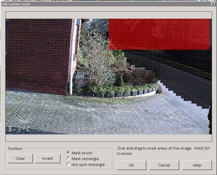

I have masked the street but still the software records if a car comes by with headlights full up.
Is there an option to tweak this?

The Hot spot feature (The red mask) means that it will always trigger on any motion in that area. I don;t think that's what you want is it ?
Reactions: fenderman
What avi6581 said...the mask needs to be black...also disable object detect reject on all your cameras or you will miss motion.

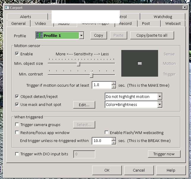

Also remember its always better to capture more than less. So your detection thresholds should be lowered, lower the make time, to something like 0.7 and move the object and contrast size to the left..You might also want to increase your break time to 20 seconds.
