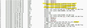

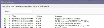

Thought I would start a new thread so not to plug up the bot thread. I am getting these results running these settings on my demo.
Thought I would try it quick on my main BI, after many attempts and restarts, I never could get it to work with my GPU Nvidia RTX A2000, it just would always return nothing found. I then just tried "NO GPU" and I did manage to get it to detect, but terrible time.
