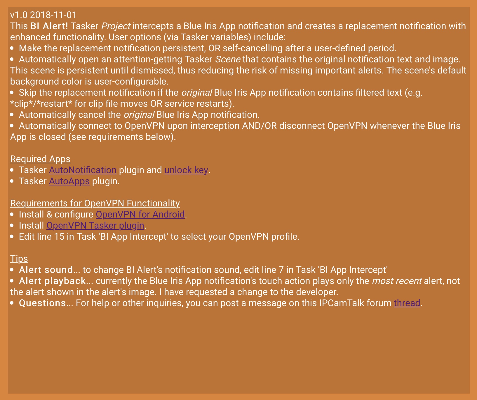

I am pleased to share a Tasker project that I have been using to enhance notifications from the Android Blue Iris App. Image 1 summarizes the project and its features. Note the requirements.
Image 1
Click this link BI Alert!to install. This must be done from your Android device.

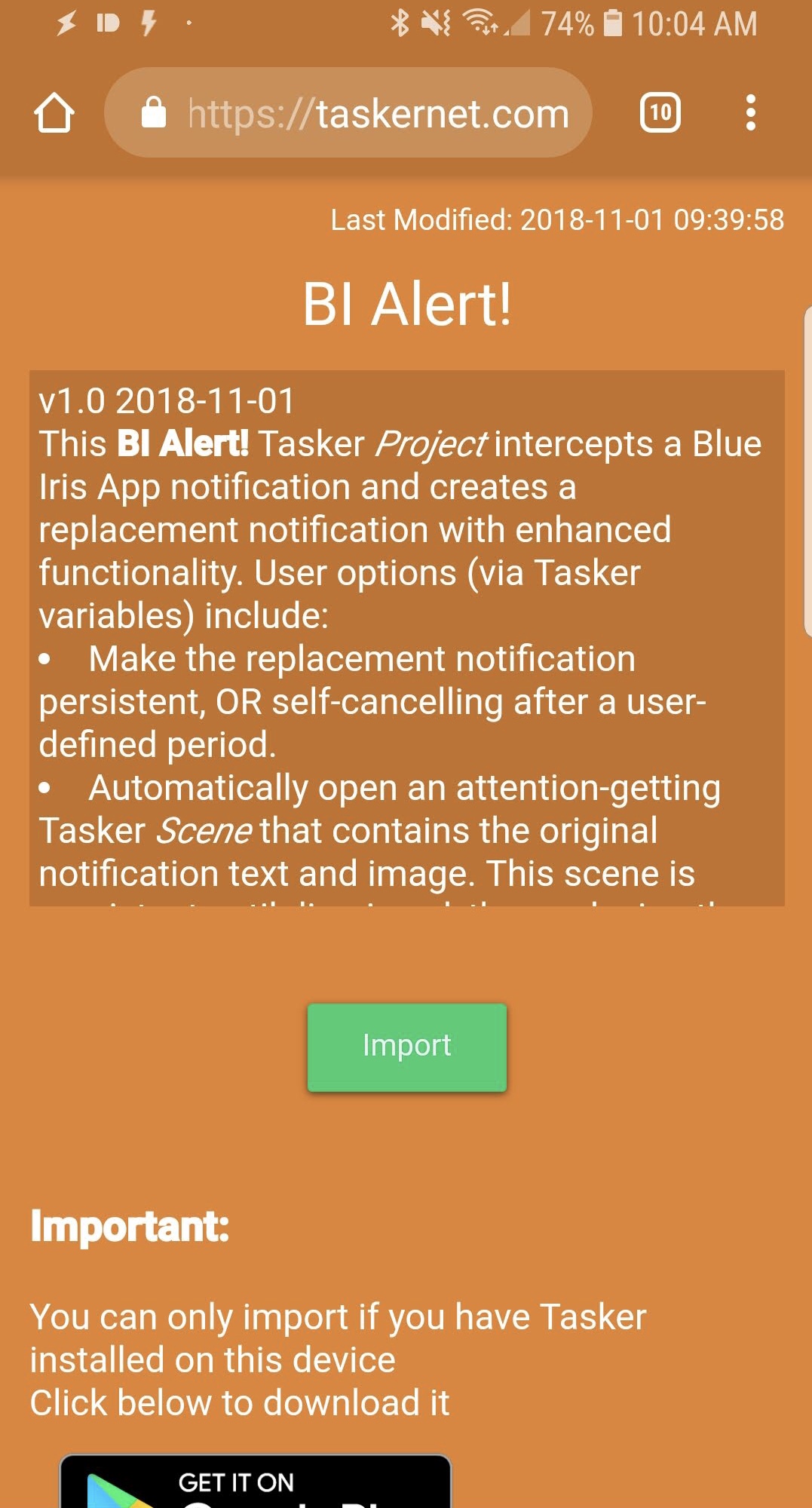

Image 2 shows what you should see. Click the green ‘Import’ button to install the entire project which includes all the required Tasker ‘Profiles’, ‘Tasks’ and ‘Scenes’. You will next be instructed to run a setup task. Please do so.
Image 2 (screenshot)

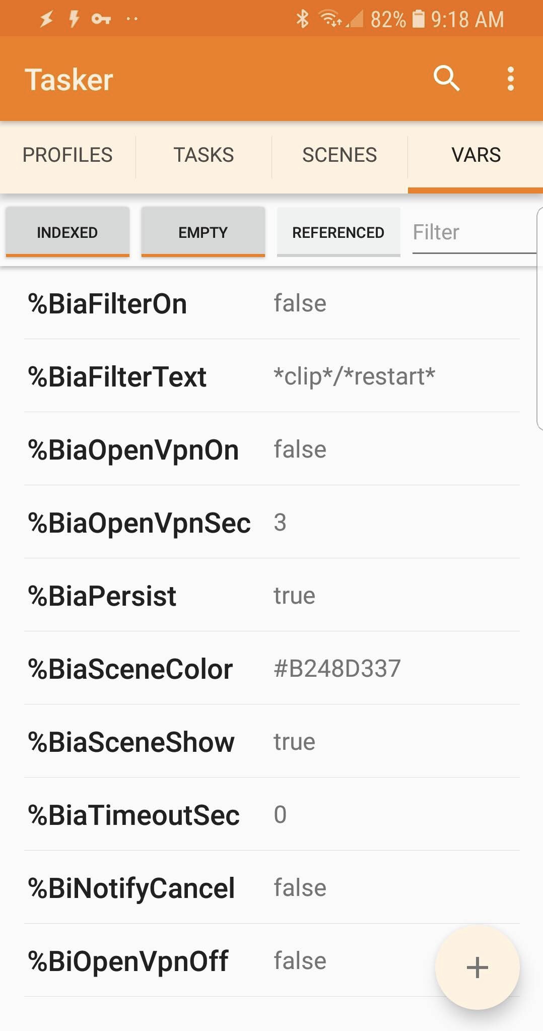

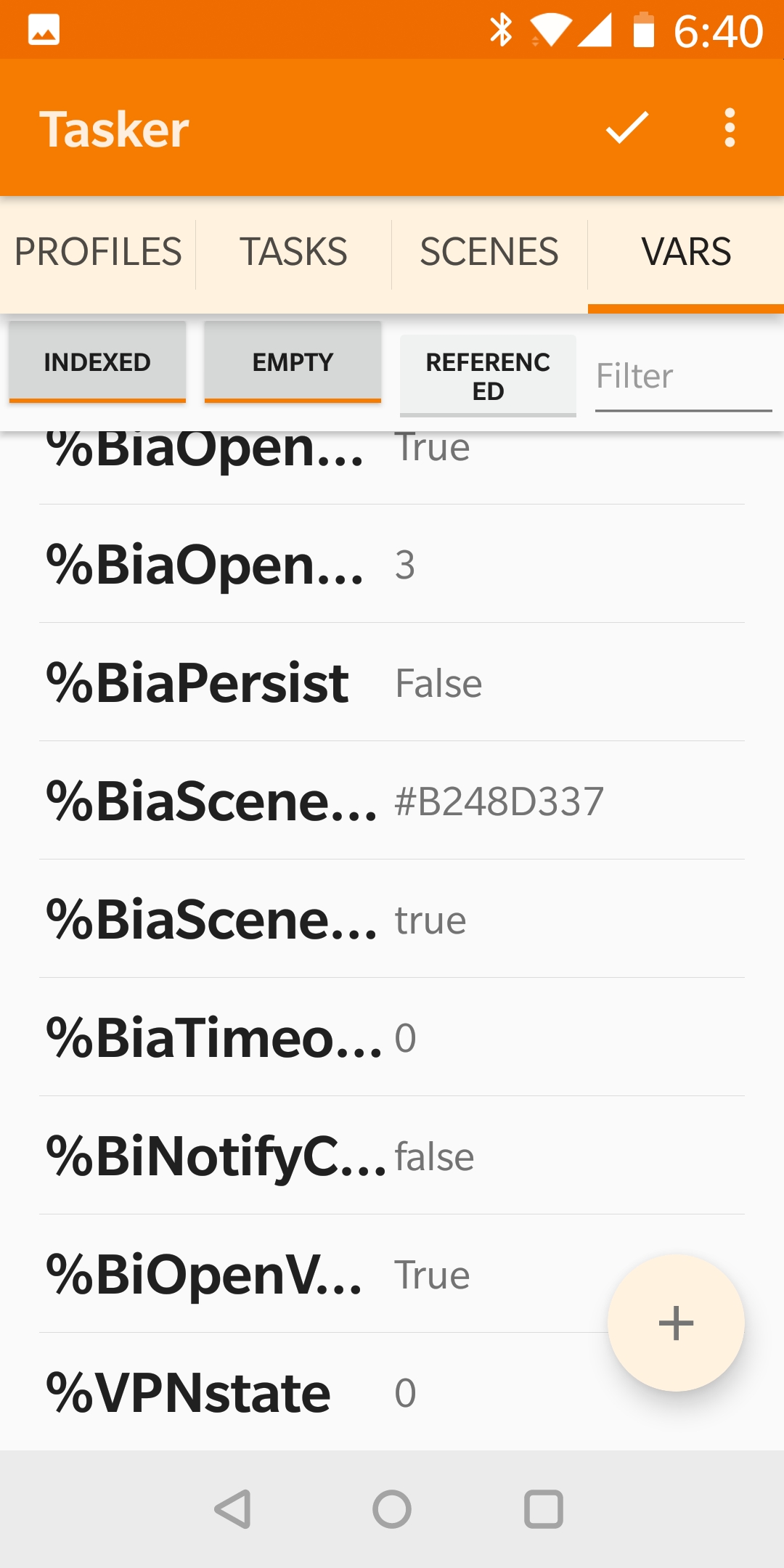

You can modify BI Alert! default functionality by manually editing Tasker variables (on the VARS tab). These are shown in Image 3. These are the default settings immediately after running the setup task mentioned above.
Image 3 (screenshot)

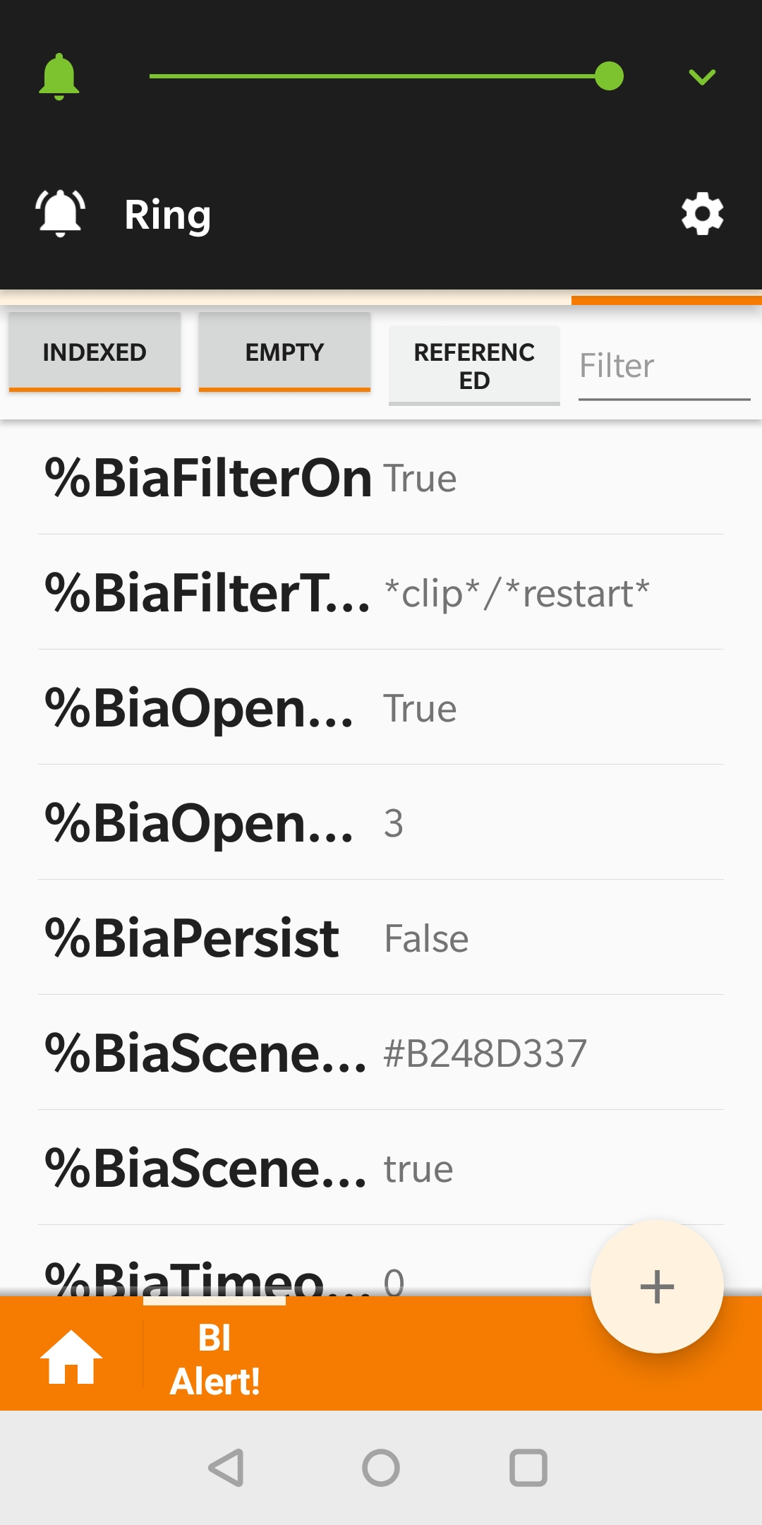

If you have correctly installed Tasker and the required plugins noted above, Image 4 shows what you will see immediately upon receiving a Blue Iris Alert notification - a replacement notification PLUS an optional persistent attention-grabbing Tasker ‘Scene’ dialog.
Image 4 (screenshot on S9 Android 8.0.0)

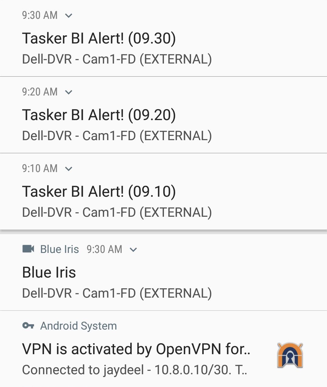

Image 5 shows my notification tray after receiving several notifications (yours may look different). Note in this case I can peruse a history of recent alert notifications, as well as the most recent original Blue Iris App notification. Tapping any replacement notification opens the Blue Iris app on the Alerts tab... Note also that because I configured BI Alert! to do so, it automatically opened my OpenVPN connection (I changed the default setting %BiaOpenVpnOn to ‘true’ - see Image 3).
Image 5 (screenshot on S9 Android 8.0.0)

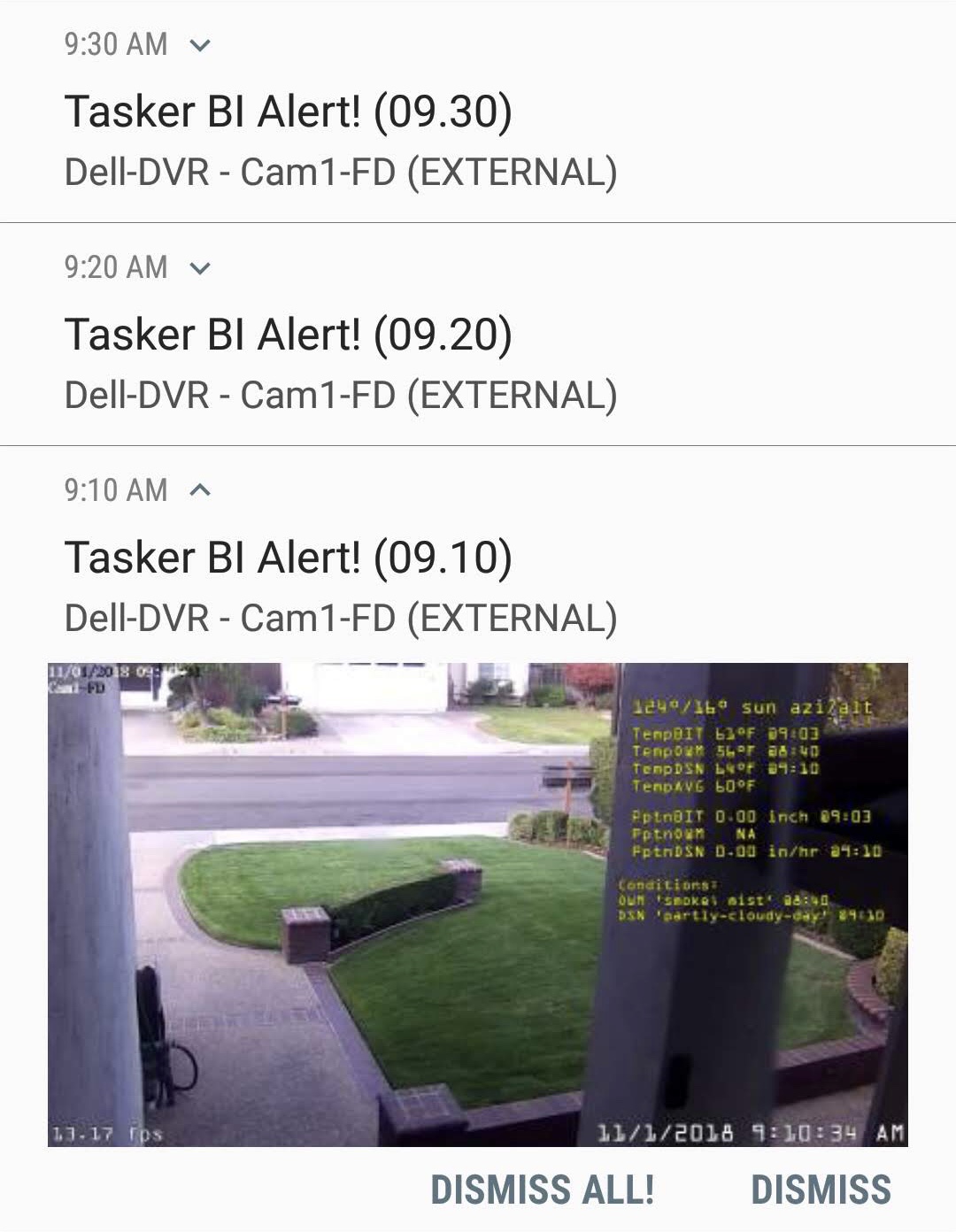

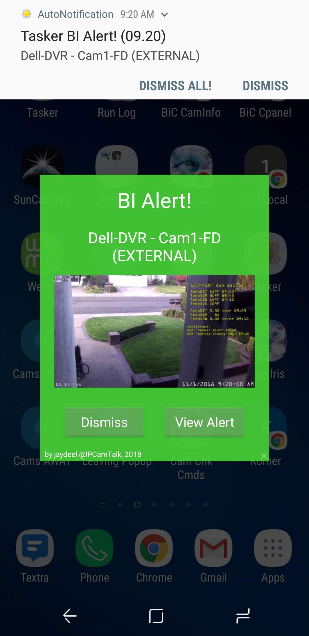

Image 6 shows how the the BI Alert! notifications appear when expanded. Touch the image to open the BLue Iris App. You can also dismiss the specific notification, or all BI Alert! notifications in the tray.
Image 6 (screenshot on S9 Android 8.0.0)

On the VARS tab, is variable %BiaOpenVpnOn = true ? ... I made the default setting false.
Also you may need to edit the wait time variable... %BiaOpenVpnSec.

Ok. I was modifying in the task tab instead of the var tab. Now I have VPN coming on, but not off. The other issue I can't figure out is why I am still getting BI notifications in addition to the new ones from this.

Setting %BiNotifyCancel = true (VARS tab) should cancel the BI App’s notification.
PS - display screenshots taken in landscape orientation will show the entire name of the variables.

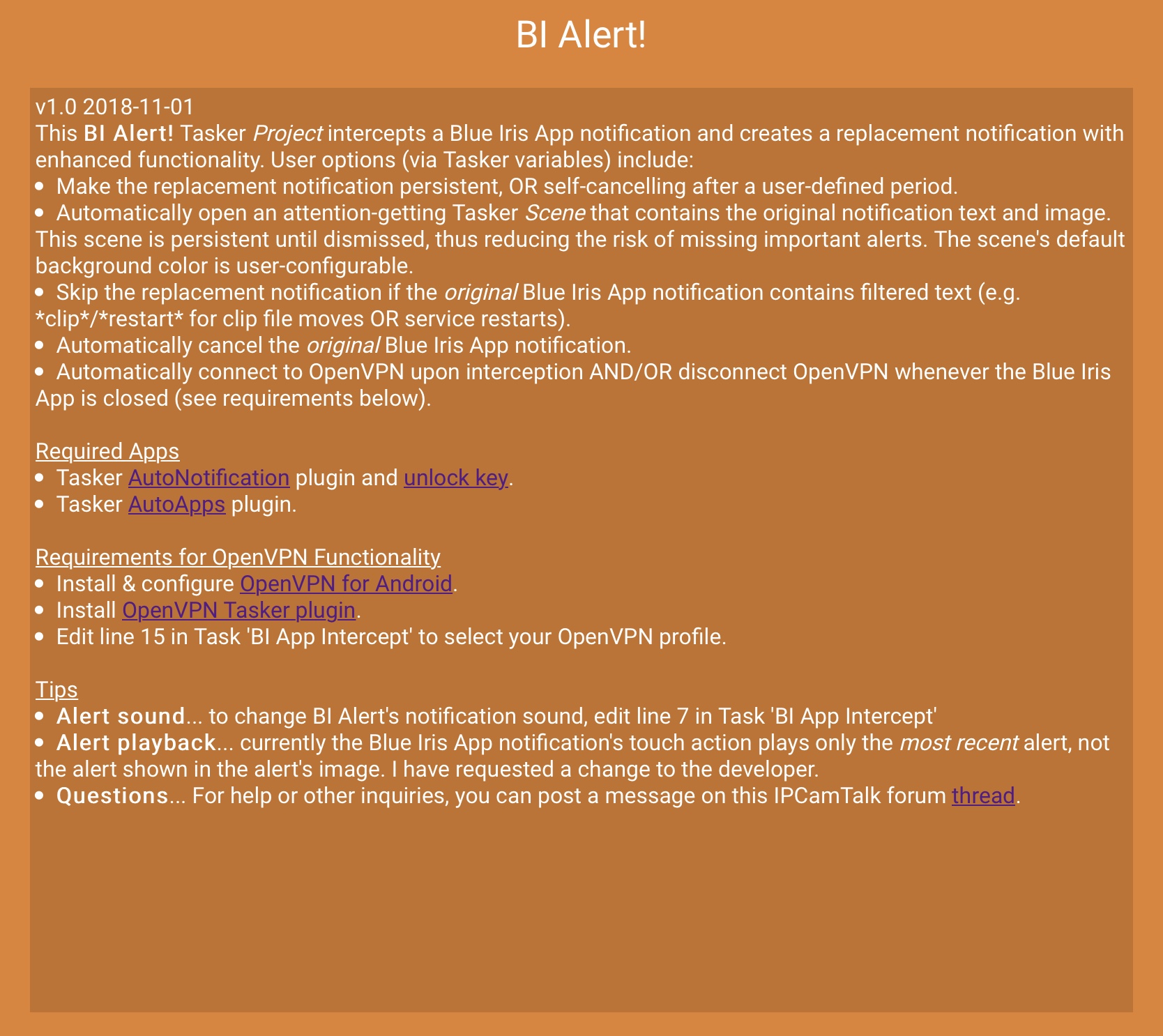

You can install the update from this link <BI Alert! V1.1>. EDIT: BI Alert updated - see v1.1a in <post #16>. This must be done from your Android device, and requires Tasker v5.5 to be already installed. Otherwise you will see Image#1 below.
If you are not reading this post from an Android device, you can view the full release blurb for v1.1 by opening the above link then clicking the 'Click here to reveal' link in the highlighted section in Image#1 below.

Image#1.

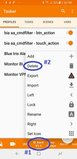

PLEASE NOTE: if you have an older version of the BI Alert! Project installed in Tasker, you SHOULD DELETE IT FIRST! ... However, before you do this, consider Tips #1 and #2 below... When you are ready to proceed, Image#2 shows how to delete a Project. Step #1 is to long-press the Project's name to reveal the context menu.
