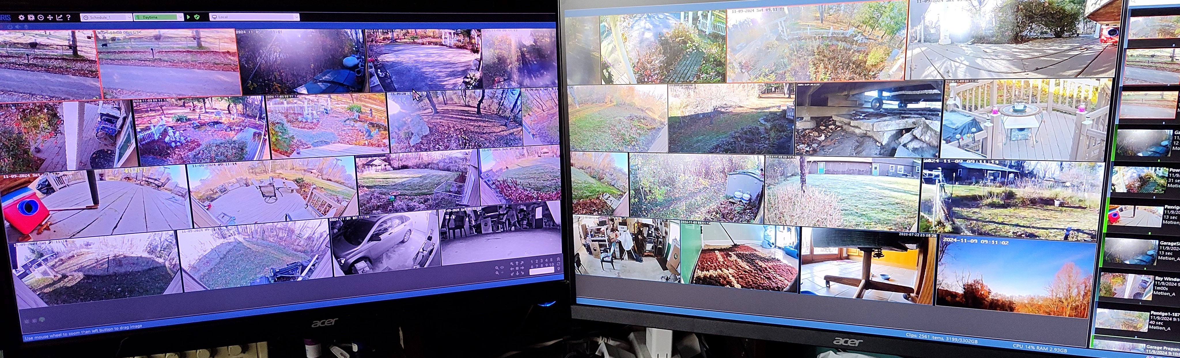

Probable brain fart going on here. I've decided to change my monitor setup and have BI extend to both displays. The problem I'm having is that I simply cannot find where to NOT show video clips in full screen (which is now across two screens). At one time, it'd be a matter of going into Settings/Video and then uncheck the box for "video clips in full screen". There is no longer a Video area under Settings and I can't for the life of me find where that parameter gets set. Would somebody please set me straight?
I still haven't found anything. It sure would be nice to have the clip played on a single monitor without having to change the BI setup down to single monitor in order to do so. I'll be sending this to Ken to see what I'm missing (if anything.

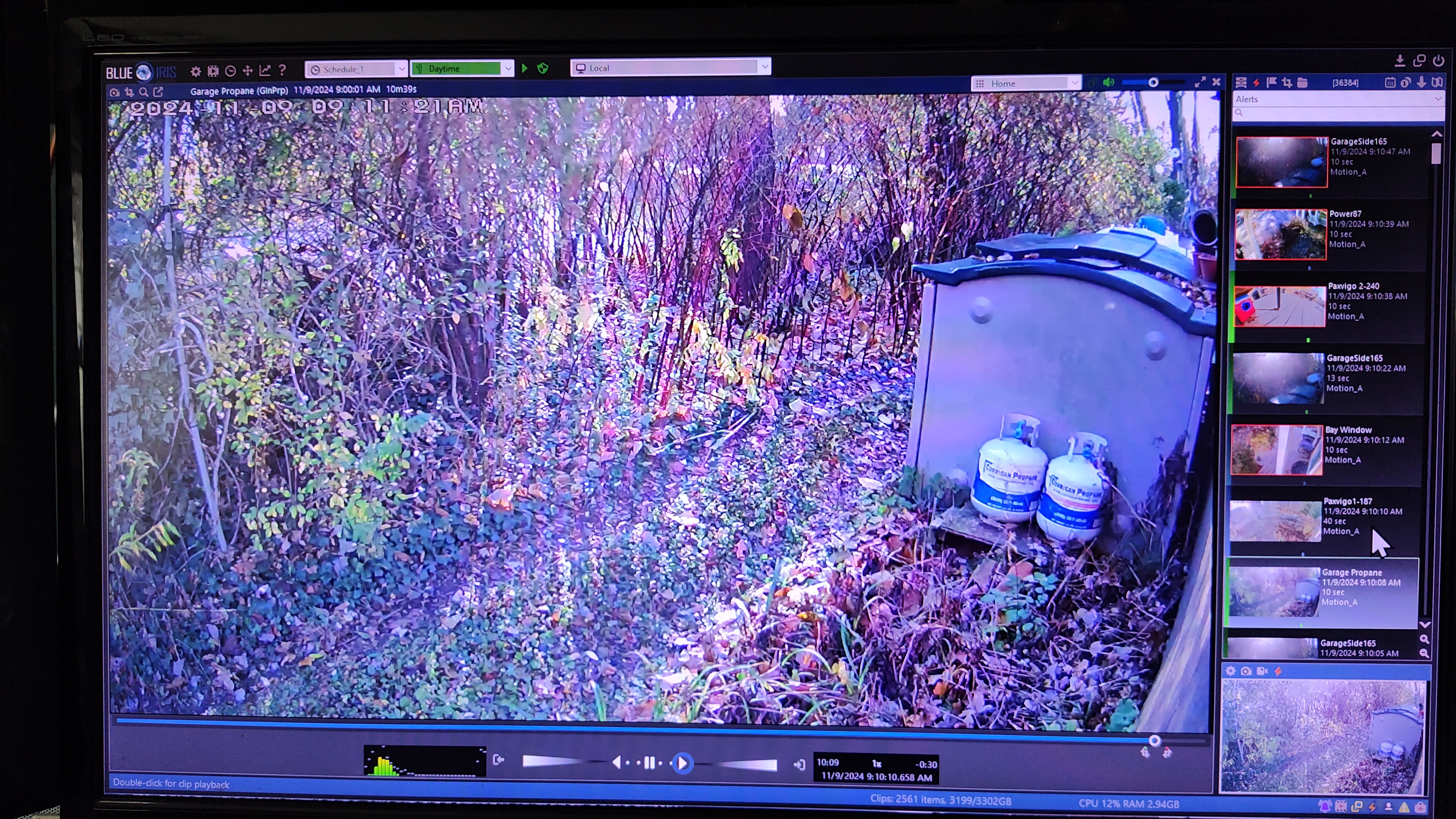

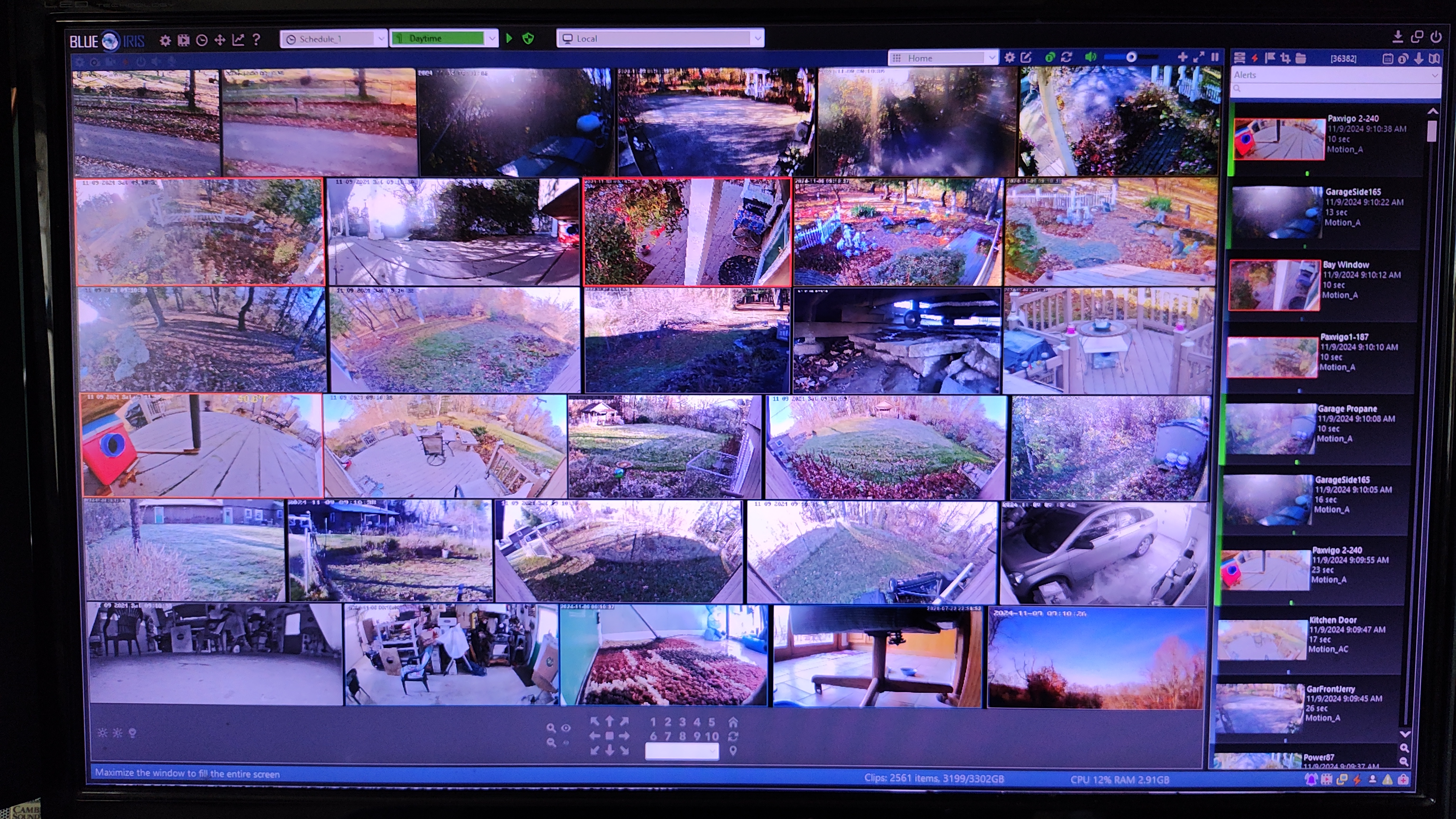

Single monitor and then with clip:

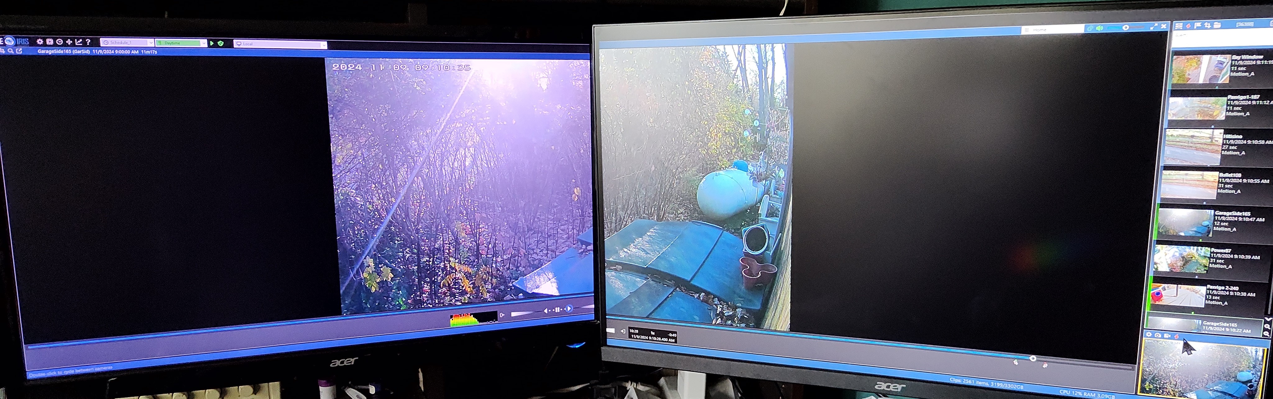

Dual monitors and then with clip:

Yep, the only thing is... stretching it to two monitors makes all the cams larger (which was the whole idea for me).
