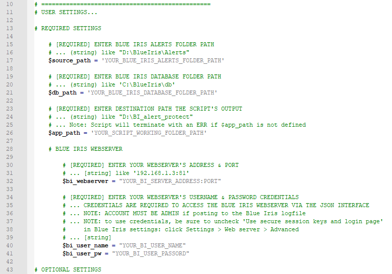

STEP #2:
Edit the user settings file
  1. The user settings file is named 'BI_alert_protect_user_settings.ps1'
  2. Open the file in a text editor (a code text editor is recommended; I use Notepad++)
  3. Edit the REQUIRED SETTINGS section (see screenshot)
  4. Ignore the remaining settings for now. They provide customizations that you may want to explore later.

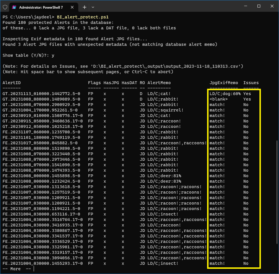

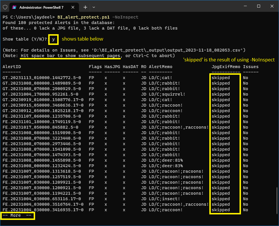

The response should look like following two screenshots
This screenshot illustrates the first screen of output to the PowerShell Console.
Key features are highlighted.
The 'Flags' column shows if the Alert's database 'Flagged' and 'Protected' flags are set.
The 'RO' column shows if the read-only file attributes are set for the JPG and DAT files (if they exist)

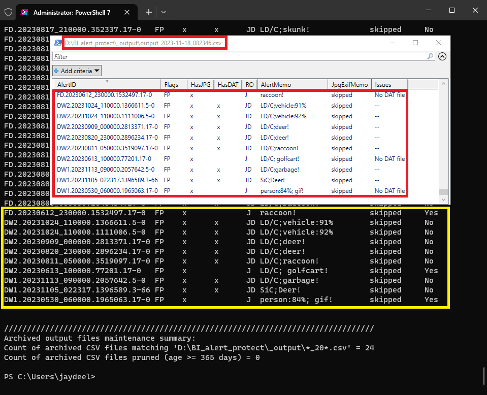

This screenshot shows the result after hitting the keyboard spacebar until all results are displayed.
Additionally, it shows the timestamped output CSV file (displayed over the Console output).
Note that this file contains the details for those issues that have a 'Yes' column entry in the Console output.

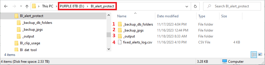

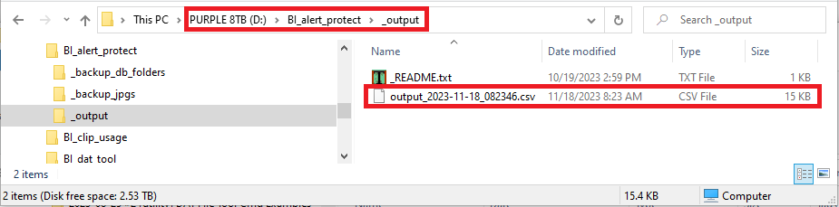

When executed, the script creates the following folders.
It also creates the 'fixed_alerts_log.csv' if any Alerts have been 'fixed'.
The timestamped output CSV file is located here:

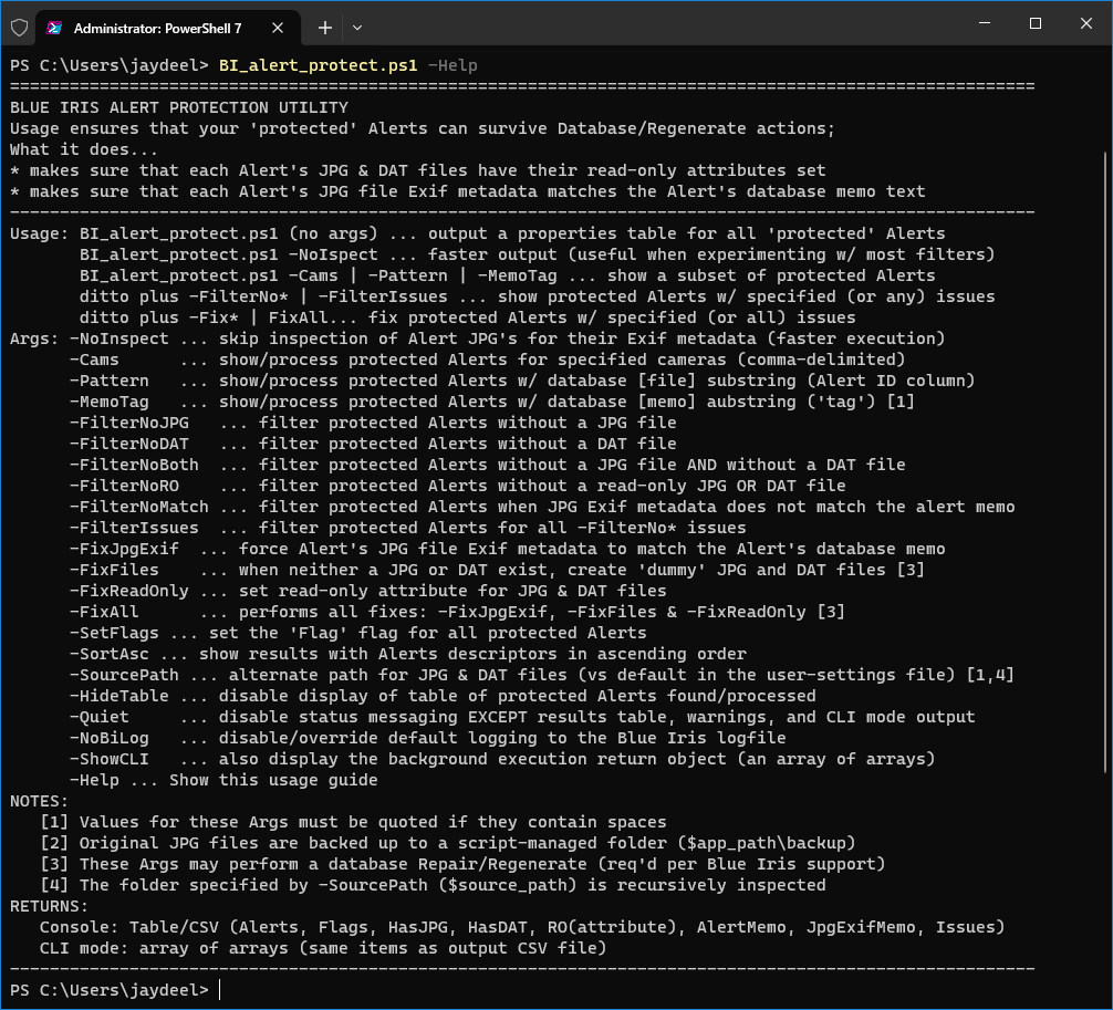

Finally, here's a screenshot of the script's help screen.

GETTING HELP
1. I want to see only the help screen
bi_alert_protect.ps1 -Help
INSPECTING PROTECTED ALERTS
2. I want to see FAST results without waiting for the script to inspect the Exif metadata in the all the JPG files
bi_alert_protect.ps1 -NoInspect
3. I want to see results for all my protected Alerts
4. I want to see results for only those protected Alerts THAT HAVE ISSUES
bi_alert_protect.ps1 -FilterIssues
5. I want to see results for only those protected Alerts that have a specific issue
bi_alert_protect.ps1 -FilterNoJPG ... that lack a JPG file
bi_alert_protect.ps1 -FilterNoDAT ... that lack a DAT file
bi_alert_protect.ps1 -FilterNoBOTH ... hat lack both a JPG & DAT file
bi_alert_protect.ps1 -FilterNoRO ... w/ JPG or DAT files do not have their read-only file attribute set
bi_alert_protect.ps1 -FilterNoMATCH ... w/ database memos that do not match the JPG Exif metadata
6. I want to see results for only a single camera, or specific cameras
bi_alert_protect.ps1 -Cams "DW1"
bi_alert_protect.ps1 -Cams "DW1,DW2"
7. I want to see results for only a single Alert, where the column 'AlertID' entry is like 'GT.20231113_010000.1442772.5-0'
bi_alert_protect.ps1 -Pattern "1442772"
8. I want to see results for only Alerts that have a specific substring
bi_alert_protect.ps1 -MemoTag "!"
FIXING PROTECTED ALERTS WITH ISSUES
9. I want to fix all of my protected Alerts THAT HAVE ISSUES
Note: the following commands yield identical results, The only difference is in the the contents of the output*.csv file.
bi_alert_protect.ps1 -FixAll ... output*.csv file lists ALL the protected alerts inspected
bi_alert_protect.ps1 -FilterIssues -FixAll ... output*.csv file lists only the protected alerts that have issues
10. I want to fix specific issues for a subset of my protected Alerts
bi_alert_protect.ps1 -FilterNoJPG -FixFiles
bi_alert_protect.ps1 -FilterNoDAT -FixFiles
bi_alert_protect.ps1 -FilterNoBOTH -FixFiles
bi_alert_protect.ps1 -FilterNoRO -FixReadOnly
bi_alert_protect.ps1 -FilterNoMATCH -FixJpgExif
11. I want to fix all issues for only a single camera, or multiple cameras
bi_alert_protect.ps1 -Cams "DW1" -FixAll
bi_alert_protect.ps1 -Cams "DW1,DW2" -FixAll
12. I want to fix all issues for only a single Alert, where the AlertID is like 'GT.20231113_010000.1442772.5-0'
bi_alert_protect.ps1 -Pattern "1442772" -FixAll
13. I want to fix all issues for only Alerts that have a specific substring
bi_alert_protect.ps1 -MemoTag "!" -FixAll
14. I want to 'Flag' all of my protected Alerts in the Blue Iris database
Handy if you manually 'Flag' your protected Alerts (this designation is lost with a database Delete/Regenerate action)
bi_alert_protect.ps1 -SetFlags -NoInspect

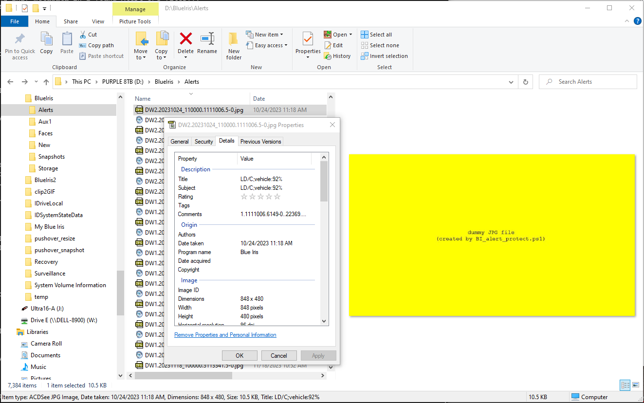

If the script repairs a protected Alert that is lacking a JPG file...
The following actions are performed by the script:
  • A dummy JPG file is created in the Blue Iris 'Alerts' folder.
  • The file is given the expected filename.
  • The file is give the expected timestamp.
  • The file is given the expected Exif metadata.
  • A Blue Iris database Repair/Regenerate action is executed (to import the JPG's info into the database).
Please note that after creating the missing JPG file, the Blue Iris clips list will continue to display the small alert image stored in the database.
It is only AFTER a database Delete/Regenerate action has occurred that dummy JPG will appear in the clips list.
EDIT: V3 of the script no longer creates a yellow replacement JPG when a DAT file cannot not be found. The replacement image can now be extracted from the BVR file.
Example:
Here's what we expect to see when inspecting the Example Alert's JPG file.
Note that the file has the appropriate timestamp and Exif metadata.
BTW, Ken provided the following when I asked for an explanation of the Exif 'Comments' field...

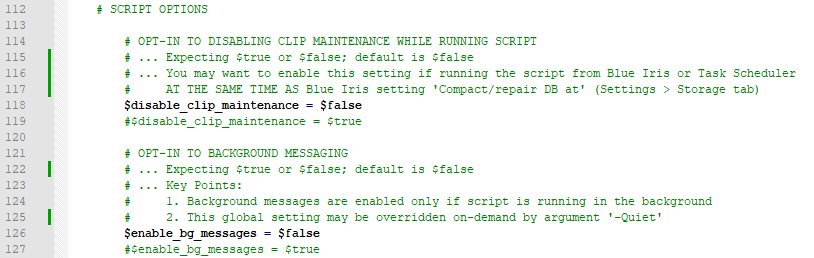

This new version may helpful if you want to automate the script via Task Scheduler (I'm running it daily).
It provides:
  • more informational messaging via the Blue Iris logfile (#6).
  • a user setting to confirm background execution (#5).
  • a user setting to temporarily disable database maintenance actions (#4).
Changelog:
  1. BUG: fixed script incorrectly detecting if running in background (via Task Scheduler, or Blue Iris)
  2. BUG: fixed duplicate entries in the 'Issue(s)' column in the script's log file ('fixed_alerts_log.csv')
  3. NEW: added progress bar for alertlist parsing (provides quicker console feedback when the script starts)
  4. NEW: added user setting $disable_clip_maintenance to avoid possible simultaneous Database/Repair actions
  5. NEW: added user setting $enable_bg_messages for temporary use to verify background execution
  6. IMPROVEMENT: made posted messages to the Blue Iris logfile more informative; now includes script's runtime, and counts of issues found & fixed
  7. IMPROVEMENT: argument -DevMode now outputs more timing information; demos the dummy JPG; saves each camera's alertlist

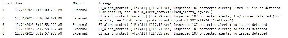

The following screenshot shows examples of improved entries in the Blue Iris logfile:
The following screenshot shows the new USER SETTINGS.

Key features of this new version are:
  1. In recognition that the usage options are formidable, the script now performs argument validations, and feedback if the commandline includes unsupported arguments.
  2. Improved dummy/replacement JPG creation - 3 methods are now used, in this order: 1) from the DAT file (if it exists & is valid), then 2) from the Alert's BVR clip file (if it exists), then 3) the Alert's database thumbnail image. If all 3 methods fail, the script then creates a solid yellow dummy/replacement JPG. For DAT files, the AI-confirmed image is used (if it exists), otherwise the middle image is used. For BVR files, the image used is grabbed at the Alert's 'offset'; furthermore, these images may be customized via user settings.
  3. When grabbing JPGs from BVR files, the script now supports multiple Blue Iris 'New' folders.
  4. Improved the method for setting that CreationTime & LastAccessTime attributes for dummy/replacement JPGs; previously, the script set only the LastWriteTime, which could result in incorrect database timestamps when the protected Alerts were recovered during a Blue Iris Database/Regenerate action. (Note: The 'Date taken' Exif metadata value for dummy/replacement JPGs is automatically set by Blue Iris).
  5. Script now identifies the DAT file's confirmed image and extracts its associated AI analysis memo -- thanks @EvanVanVan .
  6. The overlay message on replacement JPGs is now optional and user customizable.
  7. Dummy/replacement JPGs are backed up before adding the overlay (thus can be recovered, if desired).
  8. The script no longer creates dummy DAT files (simple text file).
  9. Added new argument -AllAlerts to process Alerts regardless of 'Protected' flag.
  10. Added new argument -Flags to analyze Alerts by DB flag, like -Flags 'F','P','!C'.
  11. Output column 'Flags' now shows if alerts are 'Confirmed' in the database.
  12. Detects & repairs Alerts w/ empty (or 'NA') memos by using the memo string from the confirmed image in the DAT file.
  13. To make repairs more obvious in the Blue Iris clips list, the script now prepends a caret (^) character (optional & customizable).
  14. Added new argument -ClearMarks to facilitate the batch removal the memo caret (^) marks.
Rare issue - Zero Date Alerts
  1. Detects & repairs Alerts w/ zero dates - from either a existing DAT or JPG file's date
  2. Added new output column 'HasZD' that shows if alert's DB record has a zero date
  3. Unfixable zero-date Alerts may be optionally deleted from the DB
To view the entire changelog, open the script file in a script editor.
Current usage guide
