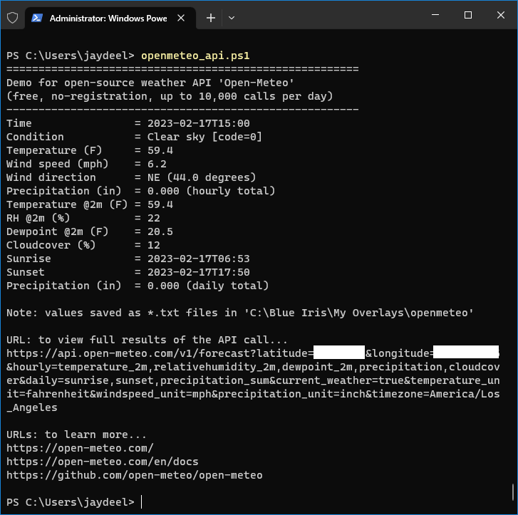

Inspired by @Chris Moore, I've created a script that illustrates how you can extract additional weather variables from the Open-Meteo API, like...
  • condition description,
  • hourly precipitation,
  • relative humidity,
  • dew point,
  • cloud cover
  • sunrise, sunset
  • daily precipitation.
See Weather Forecast API | Open-Meteo.com for more variables you can extract.
To customize the script (see the attached *.zip file) for your location, simply edit the variables in the USER SETTINGS section.
Tip: If you install Windows Terminal (link), this will make the URLs in the output clickable (ctrl-click).
  • dew point,
  • cloud cover
  • sunrise, sunset
EDIT (2023-03-27): Updated script to V2 (Updated $conditions variable).
