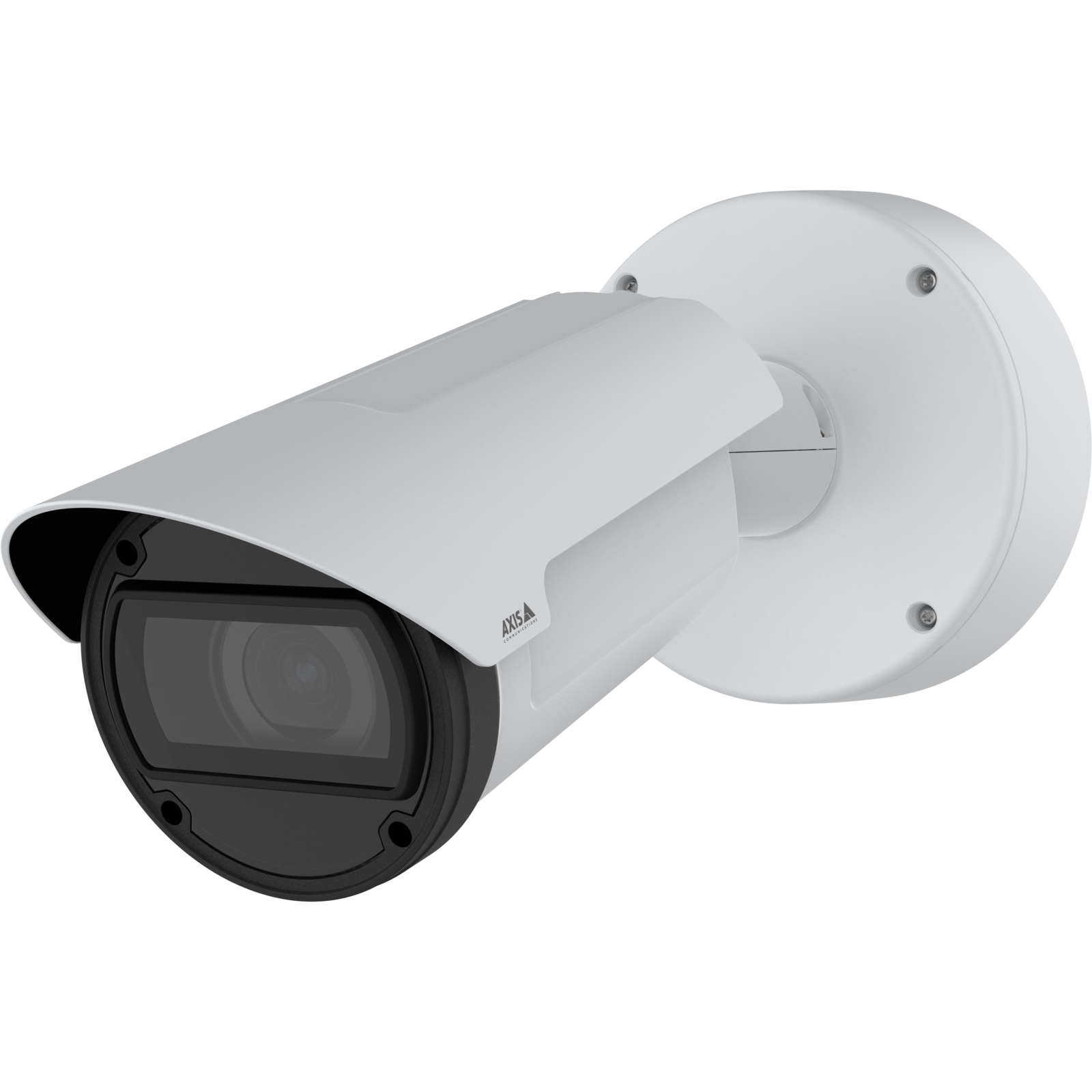

If we talk about solutions for stadiums..
Panomera cams starts at 32Mpx with 19K Euro price tag and some fancy multi sensor shit..
Axis have normal bullet, 41Mpx with one 4/3 sensor and 21-7 degree horizontal FoV lenses and 5K USD price tag..
