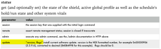

BI also has a relatively recent web API for triggering installation of an update remotely, and for reasons I cannot comprehend, he decided you can't just send in the version number the obvious way, instead it must be serialized into an 8-digit hexidecimal string that visually reads similarly to the version number and then it must be converted into a 32-bit decimal number. I can't make this stuff up. Its right here in the BI help file:
That serialization system doesn't work if any of your version number segments are more than 2 digits long, which is one way you can be fairly certain Blue Iris 6 will be released before Blue Iris 5 reaches 5.9.9.100. Because 5.9.9.100 is impossible without breaking at least one of the rigid formatting rules they created for themselves.
