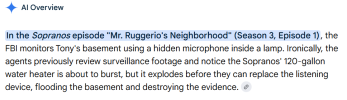

I love this Soprano's episode... Tony's basement flooding actually saved him from the FBI... :lmao:
The plumber told him it would last 10 f*ckin years... :lol:
