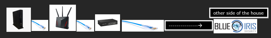

Trying to figure out how I can do this because my Blue Iris machine is in another part of the house different from where the router and POE switch are. The router and the POE where the cameras are connected to is on the other side of the house. I have one Ethernet cable running from the outside of the house to the other side where the BL machine is to give it Internet as well as my main personal computers.
It needs to be like this because the main connection for my Internet is coming into the house where the Router is plugged into, but my personal PC and Wife's PC including Blue Iris machine are on the other side of the house. We all get Internet via that one Ethernet cable that's connected to a non POE switch (5 port).
This is my setup.. hope it makes sense...
Can I use that Ethernet cable that’s providing internet to the Blue Iris machine and the other PCs on the other side, to use it for the vlan setup?
I am saying that because the BI machine and the other PCs on the other side of the house can have Internet via wifi from the main router so they don't HAVE to use the Ethernet cable.
So I was thinking of connecting an Access Point to that POE switch (in Area 1), then use the Ethernet cable and connect it to the BI machine’s Ethernet port since it will be using a wireless adapter for Internet Access anyway.…would that work?
