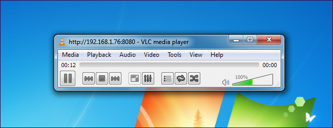

download and install VLC player. after installing it, open VLC player and press CTRL + V or CTRL + N and enter the following urls (one of them should work) if not, try googling about your camera model along with the terms RTSP URL or ONVIF URL and adjust those URL according to your local IP address and play in VLC player
URLS that may work
rtsp: / / username:[email protected]:554/11?
rtsp: / / username:[email protected]:554/12?
