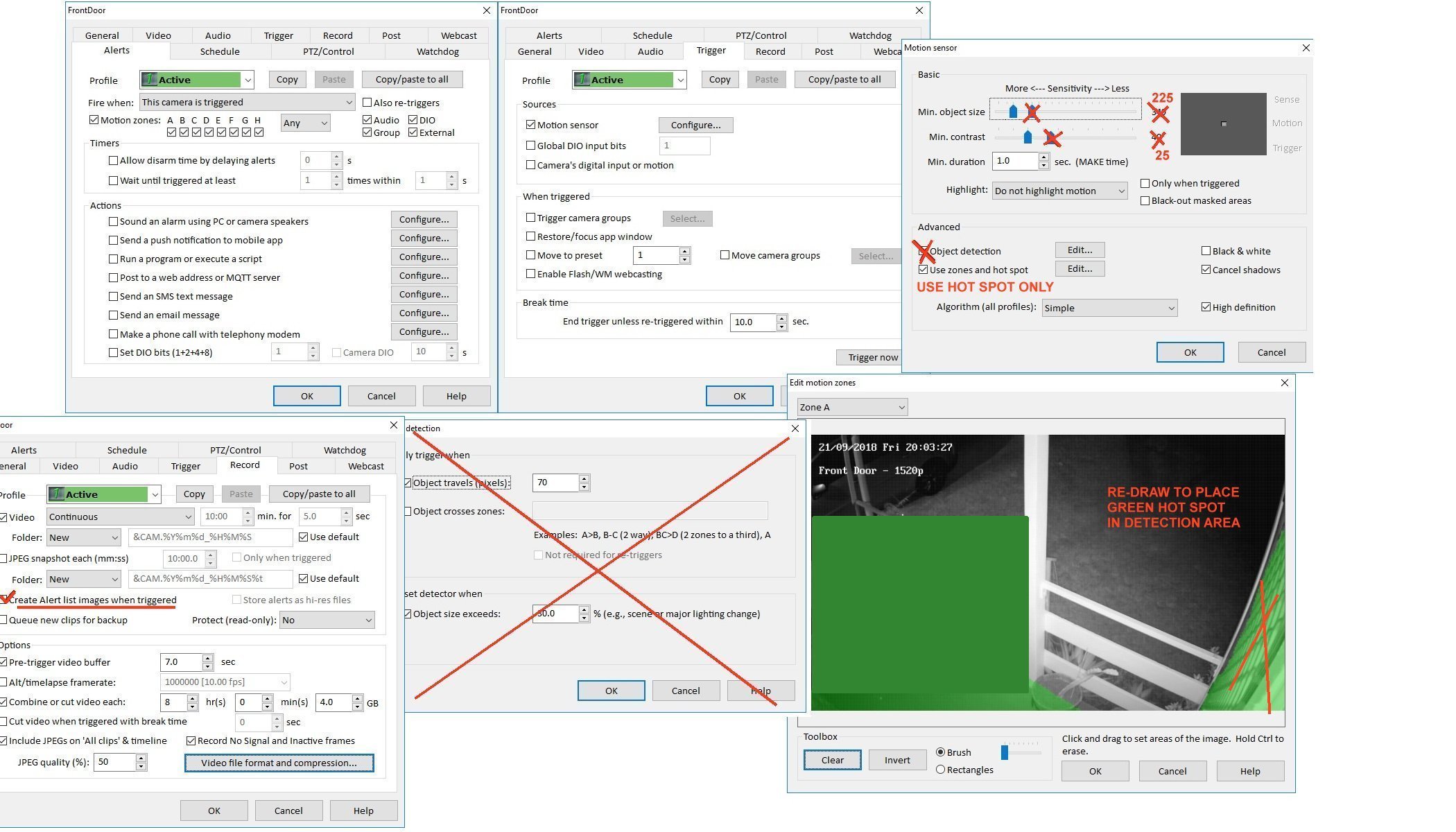

I've been tinkering for a couple of days but have only managed to get motion trigger one time out of about twenty.
No doubt I have missed or set something silly.
As mentioned I just want motion triggered at the front door to be bookmarked/tagged.
Any feedback on my attached settings appreciated.

I have a cam on front porch that works very well keeping an eye on package deliveries. It will detect birds and lizards during the day and toads at night...and of course, 2 legged critters at all times. Below are my suggestions with your image (edited) to clarify:
1) Do not use (uncheck) 'Object Detection'
2) Re-draw green Hot Spot to cover desired detection area
3) Lower 'Min. Object Size'
4) Lower 'Min. Contrast'
5) Enable (check) 'Create alert list images when triggered'
Reactions: gwminor48
