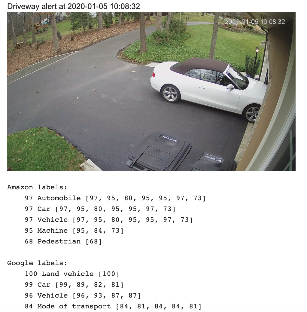

What you see below is delivered to me in email 3 minutes after a Blue Iris trigger is done. It shows the trigger image, clickable to view the video, all the objects detected by Amazon and Google and their confidence, 0-100, in their object detection. The numbers in the brackets are object detection confidence for each of the images being analyzed. Since video analysis is expensive at $0.10 per minute, I set up BI to capture images every 5 seconds along with the video during an event. Using a series of images rather than just one dramatically improved the object detection for the event.
What you don't see is that both Google and Amazon detect 20-30 objects in this view even when nothing is going on. I have set up an ignore list so the normal things like "asphalt" and "trees" are ignored. Alerts are emailed to me only when there is an object detected that isn't on my ignore list.
It was a fun hobby project and is useful for me. I am tending to use these more for a summary of activity like a morning report of what happened at my house last night than for actionable alerts. Nevertheless, I can now actually see what is happening rather than pouring through false positives.
